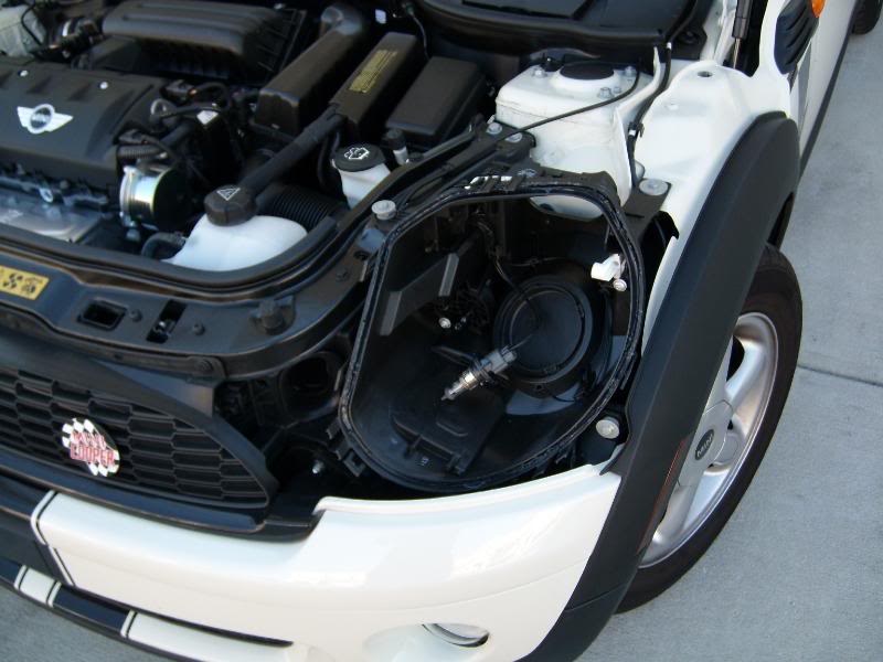

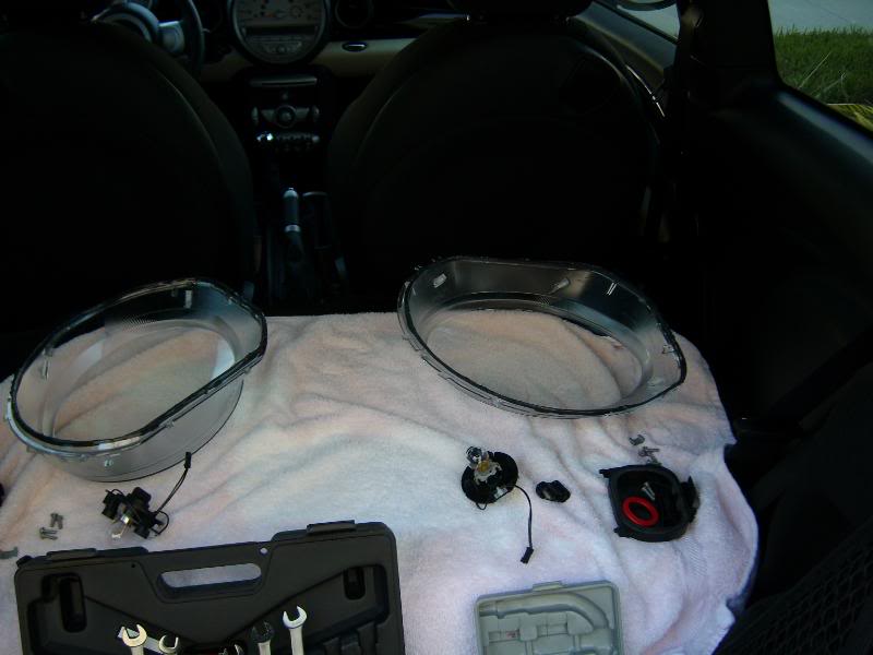

Well the lenses come off, but the housing can stay on and no baking the whole unit.
here are some pics of my disassemble (I'm not sure how much it differs from xenons, but i think it should be the same just about)
