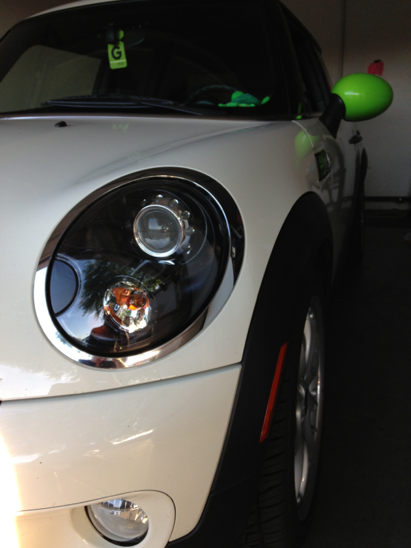

looks like it paid off! I have had Zero problems with my mod... and its been a little over a year! So just enjoy!

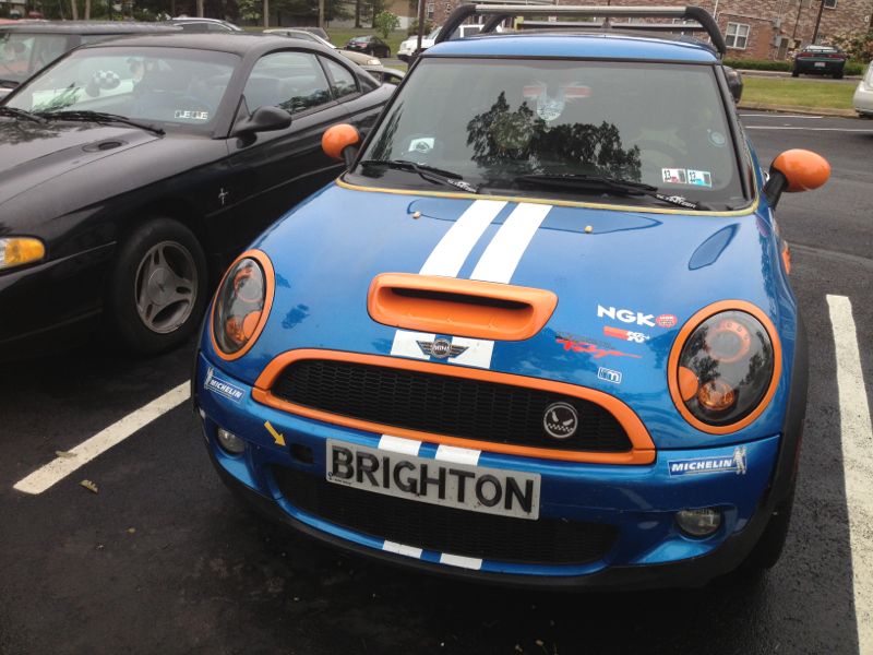

Love this mod!!
