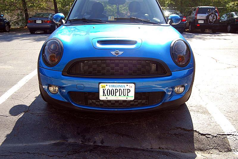

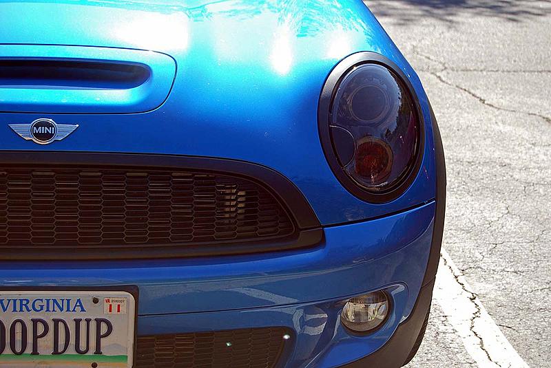

I don't remember if I posted these before or not. Back in September, I took the leap and used the .pdf file that's posted a couple of posts before this. After reading about the concerns with paint bubbling, I opted to use Hi-Temp header paint and I went with a flat black as my plain was/is to black out all of the exterior chrome with matte or flat black.
Since September, I've used the headlights nearly every day, at times, for hours and I'm not having any issues with paint bubbling, flaking or anything else.
I do have Xenon's and I hear they generate less heat but I've read several posts that suggest the Xenon ballast module gets pretty darn hot too.
The last part I'd like to do is to get rid of the yellow bulbs in the turn signals and replace them with a set of the silver bulbs that flash yellow.
Yes, I was rather nervous about putting those very expensive headlights in the oven but I followed the directions in the "how-to" listed in this forum and everything worked like a champ. I did try the heatgun method first but the only thing I accomplished was a couple of blisters on my fingers and frustration. When the assemblies came out of the oven, they were ready to come apart with minimal effort. Putting them back together was just as easy.
The end result is unique and it looks really, really good!
