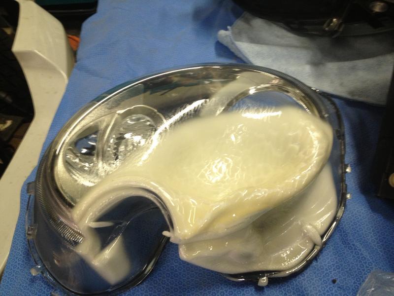

From: San Antonio
Doh !!!
Used an old crappy oven we have here at the shop and I think maybe its heat is off a little bit from what the **** actually says !!! Luckily had an extra light here so decided to just use a heat gun and it worked fine
Old Apr 25, 2013 | 08:37 PM
  #549
toolazyforalogin's Avatar
toolazyforalogin
Posts: 1,454
From: Rockland / Westchester NY
OMG I definitely used an oven thermometer when I did this.
