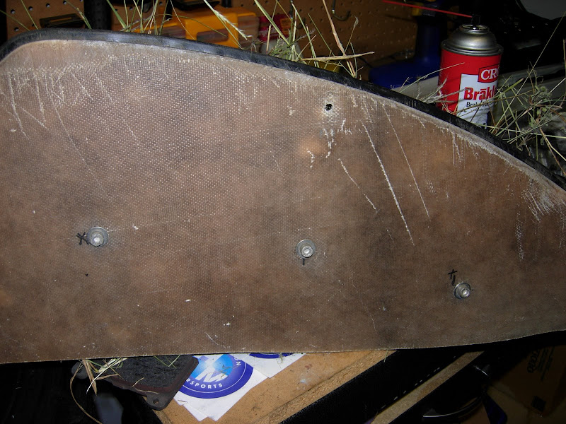

I had an incident this weekend that ripped the front bumper cover off my Mini. I was forced off the road at highway speeds. Pictures below show some of the damage. The front bumper cover needs to be replaced along with the brake ducts (only the section bonded to the bumper cover), lower grill and possibly the middle grill. The splitter may be reusable.
My contention is that 3 bolts per side that M7 Supplies are too strong. If the splitter was allowed to break away I'd be looking at $325 repair bill assuming the splitter was ruined. Instead I'm looking at probably $2000 in repairs.
Picture 1 shows how the three bolts per side, only one side pictured that hold the splitter in place. This is not per M7 instructions. There are also supposed to be screws along the trailing edge. I don't know why my tech didn't install these.

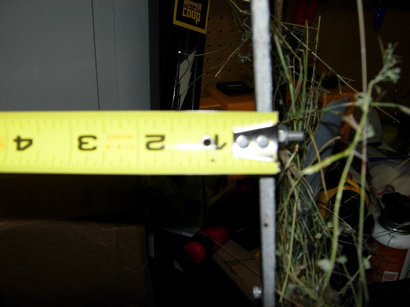

Picture 2 shows that the splitter is a 1/4" thick slab. I wonder if thinner material would offer the same performance yet would perform better in an incident.

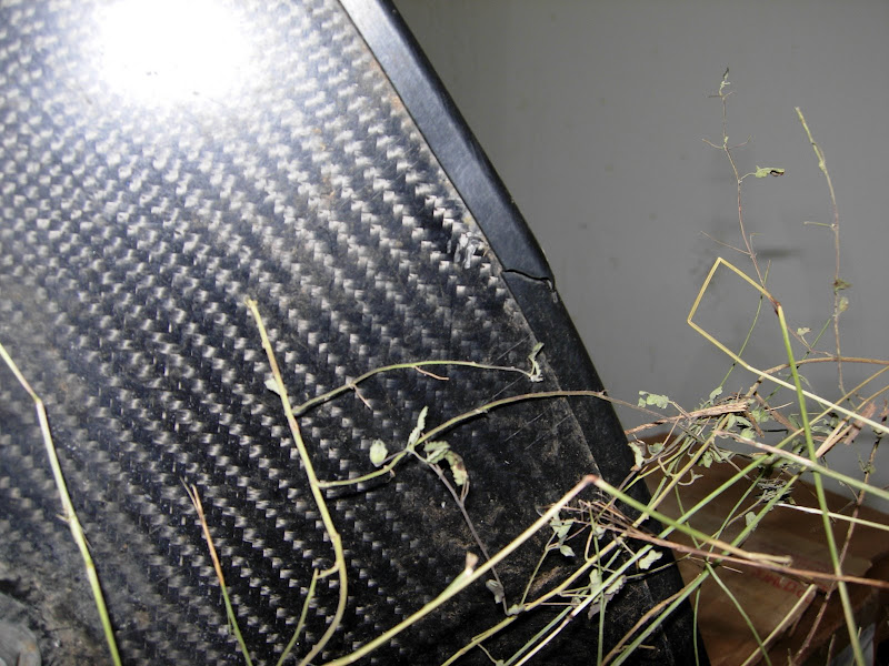

From the way the piece was laying in the field and the topped fire ant hill it was easy to ascertain the left front dug into the ant hill ripping the bumper cover from left to right. Picture 3 shows the minimal damage at the point of impact. Note in Picture 4 the tire track at the bottom of the photo. The left front tire left a mark, I might be able to buff that out.
I am thinking the next install will use something that will break away a little easier. Another person has recommended using Aluminum pop rivets. yet another has recommended 'pop-it' fasteners combined with a bead of black silicone sealer where the splitter and bumper touch. I'm open to other suggestions.
