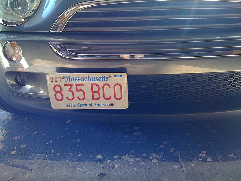

i just did this to my car. but i went a little differnt route. still used the C-clamp to get the thread but i didnt have the handle so i just used sheets of metal and made a bracket. also didnt like it so low so i bumped it up about an inch.

Alvexx's Avatar
Alvexx
Joined: Sep 2010
Posts: 35
From: East coast
a few other shots
Attached Thumbnails Interior/Exterior :: DIY license plate tow hook holder-photo-1.jpg   Interior/Exterior :: DIY license plate tow hook holder-photo-3.jpg
