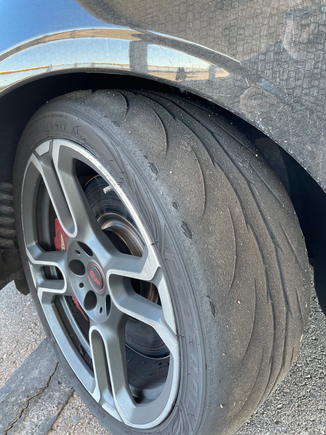

Anyway, wear on the tire seemed to be on par with the RE71R’s after a good track day, so I’m happy with that. Of course, more testing is needed, lol! Pics of the tires and a link to the video of my best lap that day below.

I should also mention that I looked at your tire pictures and note that the wear is really good. In looking at the wear with respect to the tire tread edge marker shows that the GP suspension setup matches the tires well and the tires are not rolling over on the sidewall. I would say the GP setup is good as is. Looking forward to your future adventures.

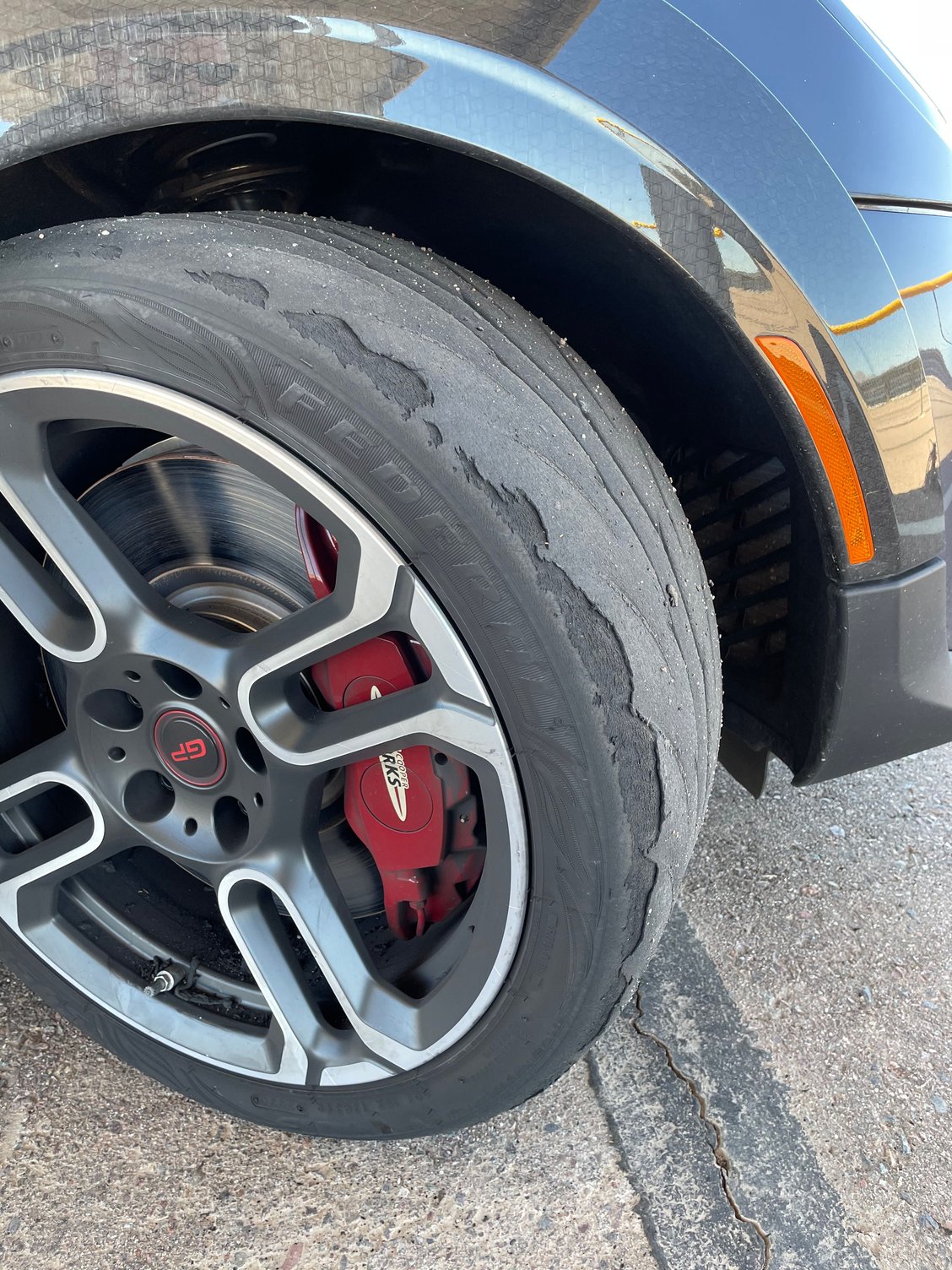

Update on the Federal RS-Pros:
I just had another trackday at AMP, but this time Counter ClockWise, which is harder on the passenger front than the driver from when going CW. I've been working on reducing my overdriving of the car (less understeering). The tires definitely seem to like more air pressure than the RE71R's, with a hot PSI at about 44-45 in front and 42-43 in the rear. I managed to set a new personal best, regardless of track direction, at 1:55.8 (video at the bottom, after the tire pics).
The tires held up pretty well, considering I'm still understeering a bit more than I'd like. The front passenger lost some tread on the outside edges, the driver side a little less so. I'm ok with the wear considering the lack of camber in front and my driving style. The rears are wearing evenly (more camber in the rear) and have plenty of tread left. I'll rotate the tires front to back and can probably get another 2 track days (4x20min sessions each) out of them. Maybe more if I can get my overdriving under more control.

David WTF at time stamp 2:23????
Did you loose your brakes or is that when you pealed the tread off the tire?
The tires - your data says you are getting 1.36g out of a street tire. That is amazing! And that could account for the tread pealing off like you show. You are getting into semi-slick territory with that kind of g loading and with semi-slick tires they say -3 deg min for camber. My guess is the g load is pulling on the tread hard enough that the tire is getting on the sidewall.
As for over driving... That video looked better. You have a nice early turn-in for some of the corners. The car looks to rotate really nicely down into the apex and you are on the gas nicely after the apex. Smooth and nicely done... Some of the other corners, maybe a bit earlier turn-in to get the car down to the apex and smooth out the turn. Avoid “driving down” to the apex if you miss it. Just stay the line you are on if you miss the apex and stay smooth on the steering. This way you have good muscle memory for creating the turn and use that with a slightly earlier turn-in on the next lap to work on getting down to the apex smoothly.
Yeah, my brakes were going out . I'm trying to figure out if I'm unintentionally cooking them or if it's just time to upgrade and if so, just pads or pads and rotors. This isn't something that happened with my MCS with the JCW Pro brake upgrade, and I always used OEM pads with those. I do have high-temp brake fluid and SS brake lines.
I'd take the G's with a grain of salt. I don't know how accurate the sensor on the GoPro's are, tbh.
