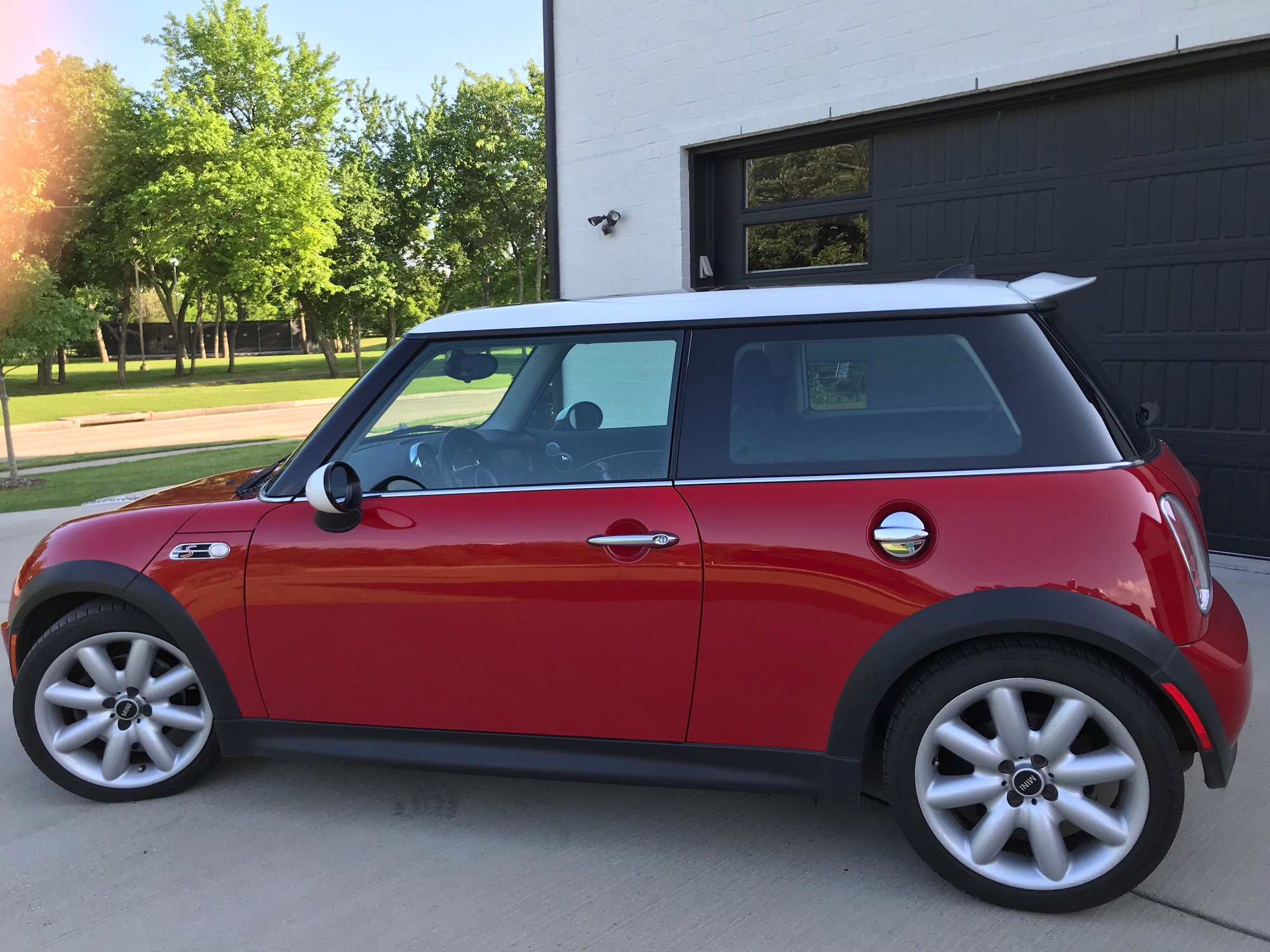

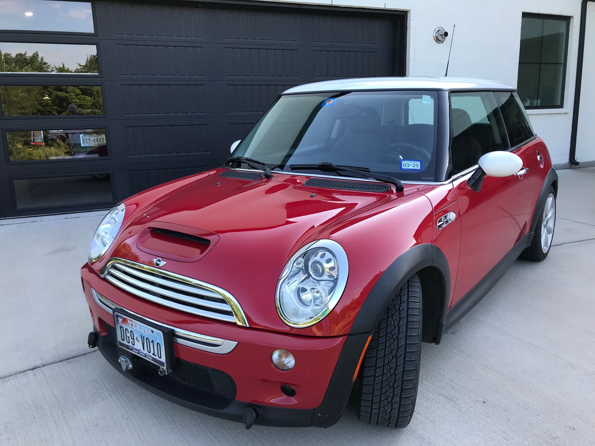

Greetings All. I have owned an R52 for about 2 years. It had 120K miles on it when I bought it, and I've had to do a lot of work to it replacing all the worn out parts. Suspension, bushings, engine mounts, plugs & wires, fuel filter (the top hosing cracked an was leaking fuel). It's running great now, changing the clutch slave next. It's all stock and I plan to keep it that way for the most part.
The R53 I just got has 52K miles on it. It's been well maintained, there is nothing worn out or needs repair as far as I can tell. The paint has some rock chips in the hood I want to try to repair, and a few minor door dings. Else it's been a pleasure to drive to work each day.
I have two general questions.
First with this relative low milage, what preventative maintenance should I be doing beyond oil changes? Do I just wait till things wear out and replace as needed, or are there known things to do before they happen?
Second, this mini I plan to mod some. It will be a daily driver, I have not plans to go to a track. Just want some mods to enhance the fun or look of the car. So far reading here I have these on my list:
15% Pulley Alta, with colder plugs
Rear Sway Bar 22mm
Cat-Back Exhaust (Milltek non resinated good?)
R98 Wheels (I like the way they look)
Anything else you's recommend? Thanks

That's a nice clean R53! The only real difference vs an R52 is that you have to check the sunroof drains to make sure they aren't clogged. The rubber parts (suspension bushings, shock/strut mounts, engine mounts, etc.) will not necessarily be bad, but you should keep an eye on them just because of their age. My R53 has 246k miles and the only thing that catastrophically failed was the crankshaft pulley damper (luckily it broke near home and I was able to limp back). Check yours to make sure the rubber isn't dry rotting. Also, every seal on mine that touches engine oil has leaked and been replaced at least once. I have the original supercharger, still going strong though I've drained and replaced the oil in it twice.
Can't say much about mods, I only have a ATI Super Damper (2%) and R112 wheels. The car is fun enough for me without too many mods.

Wow that is clean.
52K i would just check all the maintenance stuff as its been sitting.
Belt, oil change, coolant, check for any leaks if any. Filter, cabin filter, brake pin sliders.
inspection 2 is 50k miles. https://www.northamericanmotoring.co...ection-ii.html
Then mod
R85 nice wheels
Pulley & plugs , check!
cat back, check!
sway bar, check!
Intake?
Intercooler upgrade?
