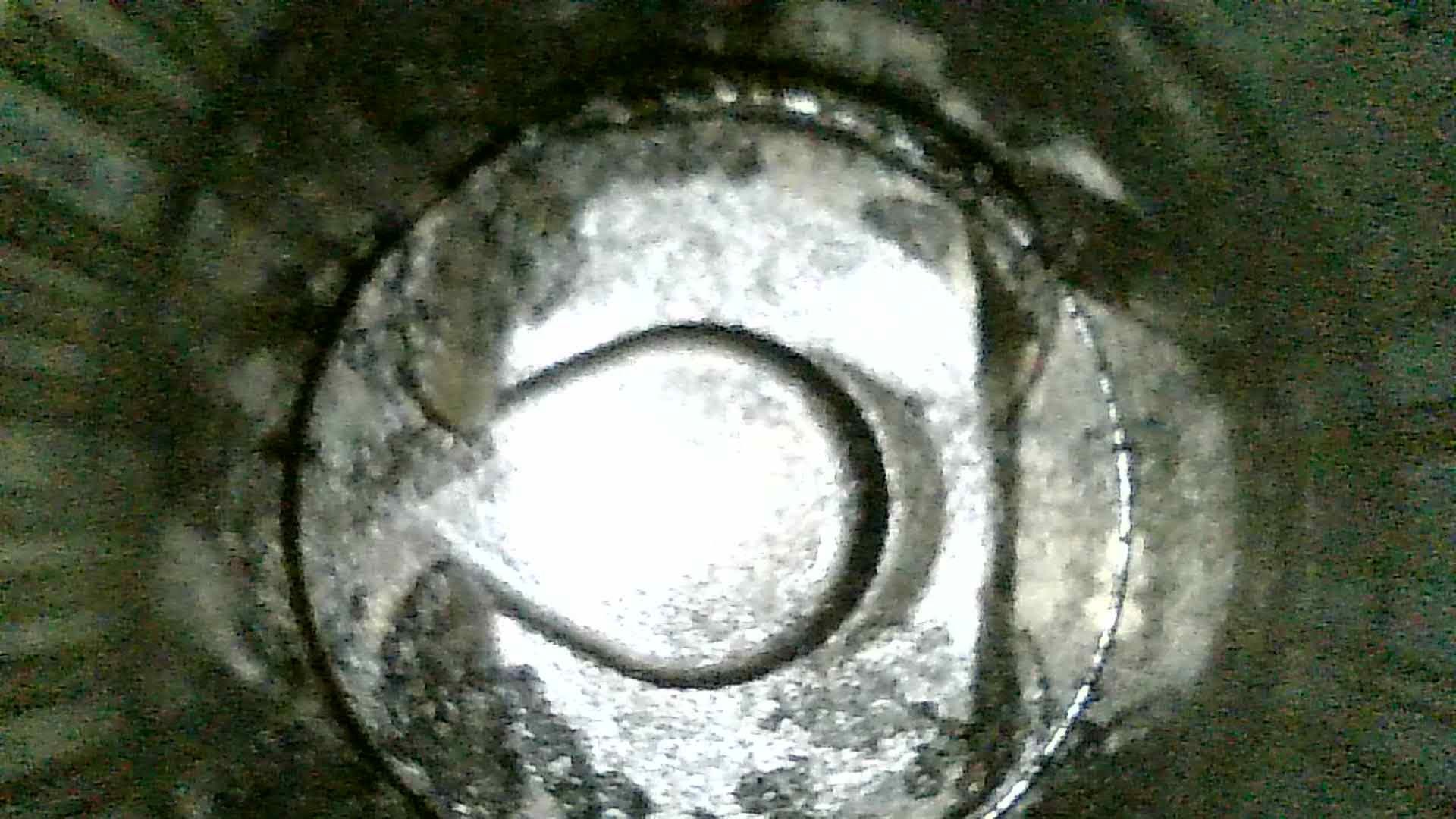

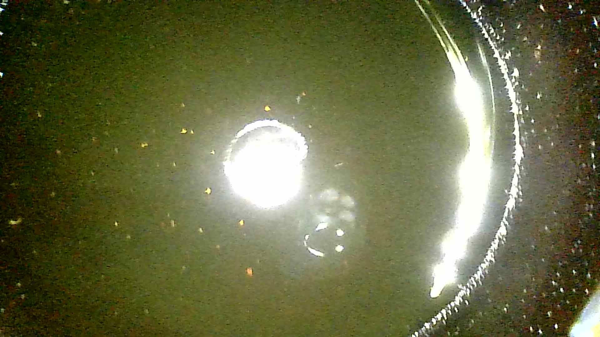

Follow up - haven't done the walnut blast yet (all parts arriving for next weekend), but did have a chance to get the cheap borescope out and look inside the cylinders.
Here's what I found:
Cylinder 1
Cylinder 2
Cylinder 3
Cylinder 4
It seems like there's carbon build-up but it doesn't seem horrible. I'm curious to see the intake valves once I get around to taking the intake manifold off.
Has anyone done a "piston soak" to clean the deposits shown above? I'm curious as to the correct procedure for it – in terms of what position to crank the cylinders to
Also, cylinder 2 looked different to me. I know the photo quality is pretty bad so it's hard to tell, but wondering if there's anything obvious to someone else as to why C2 has the lowest compression.
Old Jan 2, 2023 | 06:53 PM
DenisMcG's Avatar
DenisMcG
Joined: Jan 2017
Posts: 135
Likes: 16
That looks like either coolant or oil in cylinder 2. Run a small hose in and try to suck the liquid out so you can see what it is.
Old Jan 2, 2023 | 07:04 PM
badafada's Avatar
badafada
Joined: Jul 2021
Posts: 47
Thanks @DenisMcG . It could be leftover oil when I did the wet compression test - but strange that seems like theres so much in there when I did the same to all the others. will post another photo when I get a chance
Old Jan 3, 2023 | 04:13 AM
njaremka's Avatar
njaremka
Alliance Member
Community Builder
Community Influencer
Joined: Jul 2016
Posts: 7,534
Likes: 2,503
From: WNY
Yeah, cylinder 2 look likes it’s drowning, but #3 looks like it’s at the top of the bore. Cylinder 2 might just be too close to the camera.
