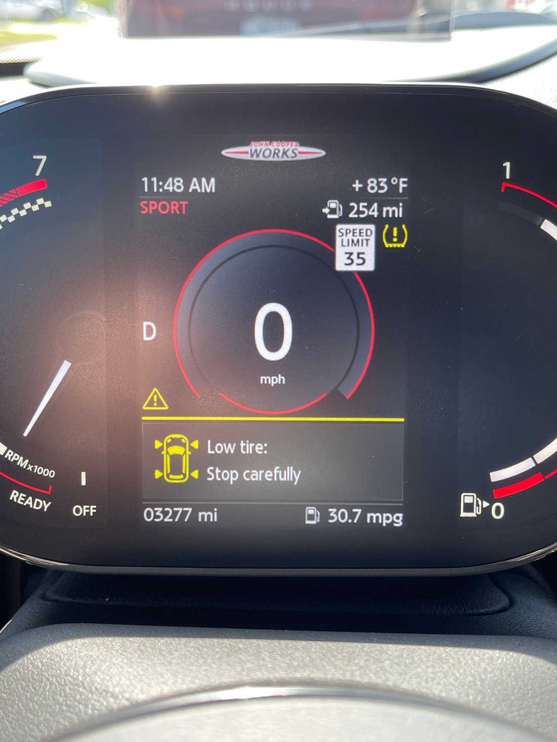

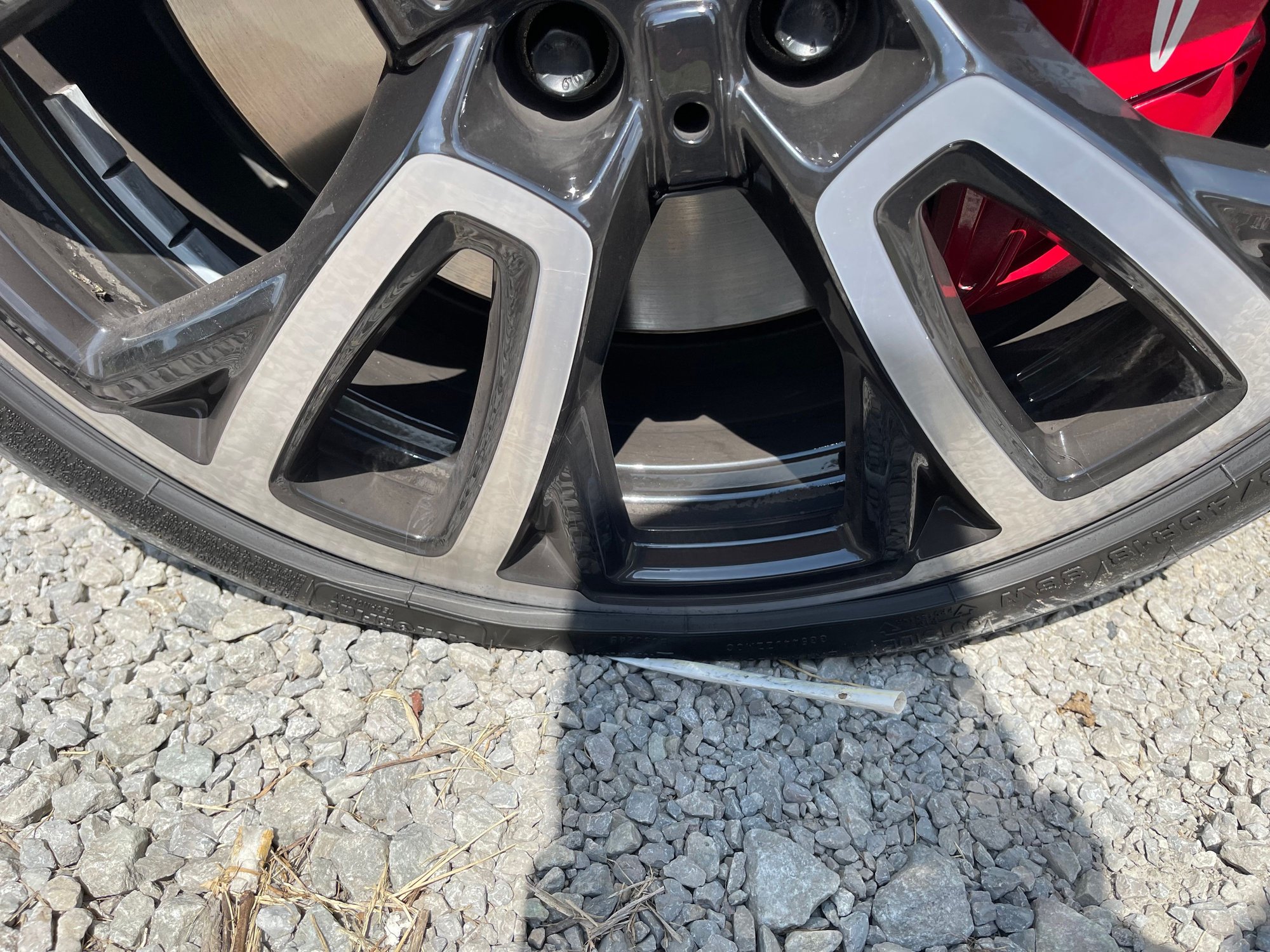

Well out for a fun drive. Hit a pothole and I knew as soon as we did we were done. Drove about 2 miles into a small town. Nothing open and the Walmart no chance of having a tire. Read up that you can drive no more than 50 miles at no more than 50 mph so we tried to drive 15 miles to a friends place. About 2 more miles and we were on the rim. Now waiting for a tow. Will start carrying a spare for now on during these fun trips.

I don't mean to blame the victim, but ultra-low profile tires just don't have the space to absorb a hard pothole hit. Runflats can only do so much when they're wrapped around those huge (but gorgeous) JCW Circuit Spoke wheels. There is literally only 3.2" between the outer edge of the tire and the bead seat. Subtract another half inch for the bead wall to keep the tire on the wheel and that leaves… not much. Maybe 2⅝" of deflection before you hit the rim?

Yeah no worries. Not trying to be the victim. It was a big hit. Not sure any tire would have survived. I just thought runflats could handle a few more miles driving on them while flat.
Going to replace the tires. Thinking about 215 40 18’s. Looks like folks have done that on the stock wheels and they fit.
