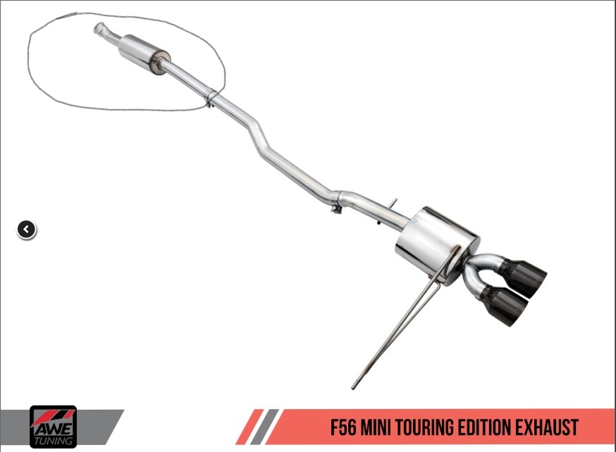

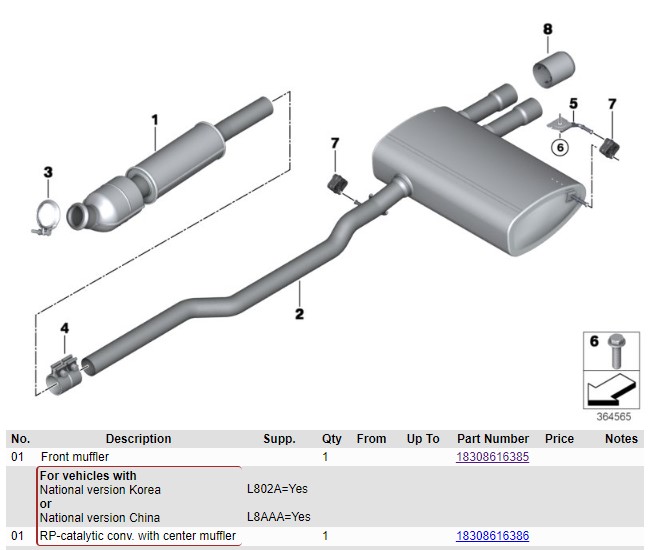

  • Failed - No 2nd catalytic - car has AWE Exhaust installed and it seems this removes the second cat (see below between #1 & #3) ? At least that is what the inspection station is telling me.
  • It seems I need PART #1 below to get this guy to pass me?? --- any forum members have this laying around after they swapped exhausts? Reference attached AWE cut sheet, seems AWE just has a resonator and deletes the 2nd catalytic. I just hope I can source a used OEM Part #1 below, and it's the same length as the circled AWE section below.

You might go hit a junkyard to see if you can find a stock exhaust you can bolt up for inspection, then put the aftermarket one back on when you pass.

As far as adding the 2nd cat like stock. The previous owner had an AWE (track edition) exhaust installed. AWE exhaust comes in 3 sections. So I bought a Magnaflow high flow cat (8" long), and cheap 4" round 10" long stainless muffler, a 4' straight piece of stainless exhaust tubing, and some V Band sets. I will cut the 1st section (connected to primary catalytic) of the AWE exhaust and a V Band. I will then V band / install the Magnaflow cat, cheap muffler and install that in place of the 1st section. Go back and fingers crossed pass the inspection. The come home and take this crap off and put the AWE section back in.
Not sure any of that makes sense but I will take some pictures. I was able to source all the materials for <$200 and my buddy will do the welding, so it was cheaper than sourcing a stock exhaust at around $300.
