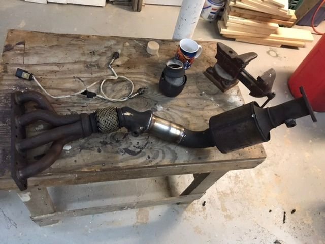

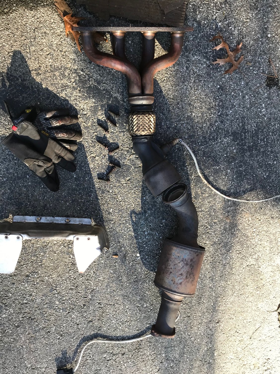

Good news: over the past couple months I’ve taken time when weather permits to slowly start removing the necessary parts to extract the exhaust manifold. I live in Northeast and broken bolts are always an issue. Everyday I went out to do some work, I sprayed pb blaster on the 8 manifold bolts.
Today we hit the mid 60s and woohoo all 8 came right out.
My dilemma: I’ve got 110k miles and want to keep this job to under $350, last awhile, and not throw codes (keep main cat and O2 sensors). Adding O2 emulators is not an option.
Current status....
R53 poor mans JCW. Cat back is JCW with the resonator removed (I still have it though), 17% pulley, JCW 210 factory tune, JCW 380cc injectors, JCW CAI.
Do I....
A) have a muffler shop re-weld pre-cat
B) have a muffler shop remove pre-cat with pipe
C) Non OEM headers (obx is just near my budget) and have a muffler shop add the oem cat

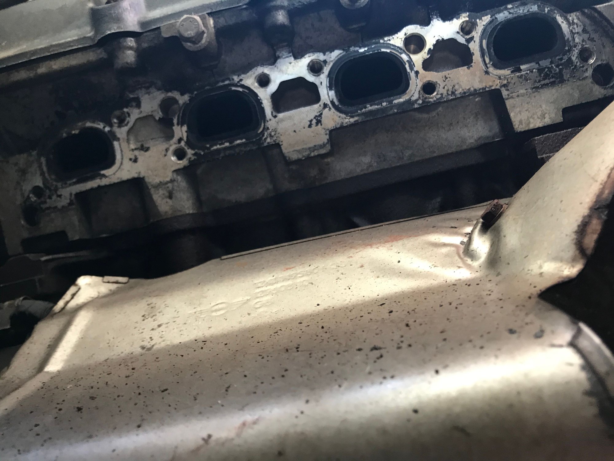

Lastly: What prep is needed at the exhaust manifold mounting surfaces besides new bolts and gasket?
Thanks.
Successful extraction
Prep?

So I brought the header to “[redacted] custom exhaust” and had them cut the pre cat and replace with a piece of SS pipe for $106.25 (included tax). They f’d up the threads on the 02 bung so they replaced that for “free” (and sensor come to find out). They also threw in a new set of flange hardware and gasket.
Final thoughts on stock header, pre-cat delete, resonator delete, and JCW SS mufflers. Meh.
Maybe since I haven’t driven it in 3 months I really can’t say if it’s better. For $100, I’m def happy I went that route.
FWIW: There was way more pop and burble with the one-ball mod so I miss that.
Precat delete due to split weld
