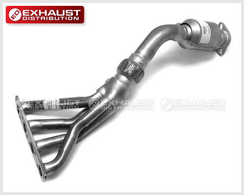

Has anybody heard of Exhaust Distribution? They have an operational header with cat but cant find any info if they are a reliable source. 420 with shipping. found it on ebay and looked up company name.
- I already have a Magnaflow catback system -
