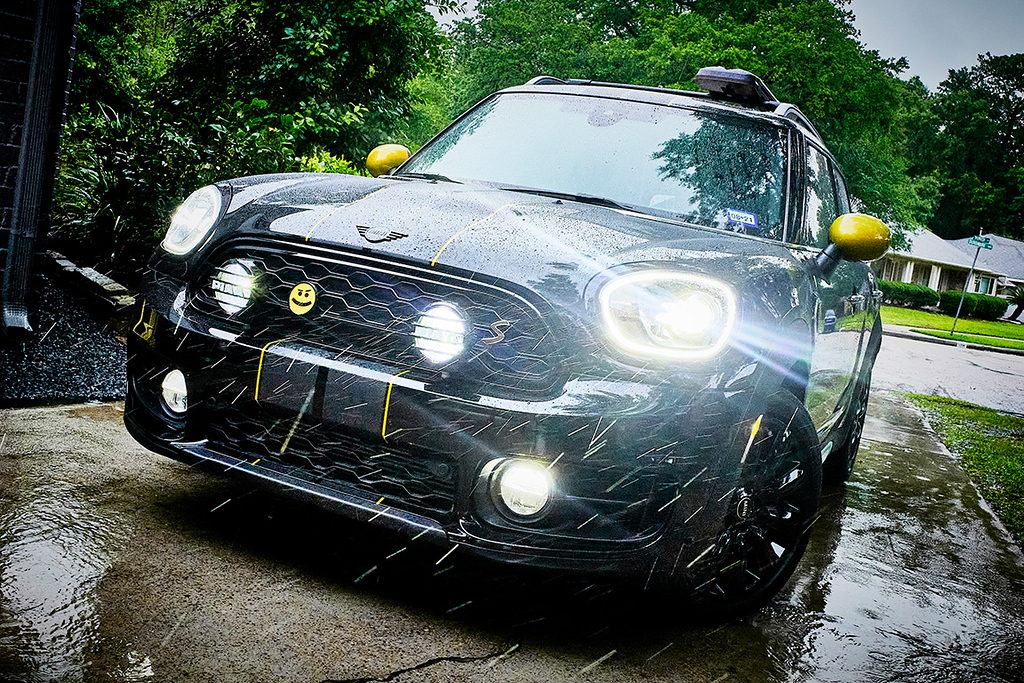

Finally got the lights from CravenSpeed and installed them!
Work great. Not too bright. Can turn on any time i want. Install was a cinch with really clear instructions. Perfect.
