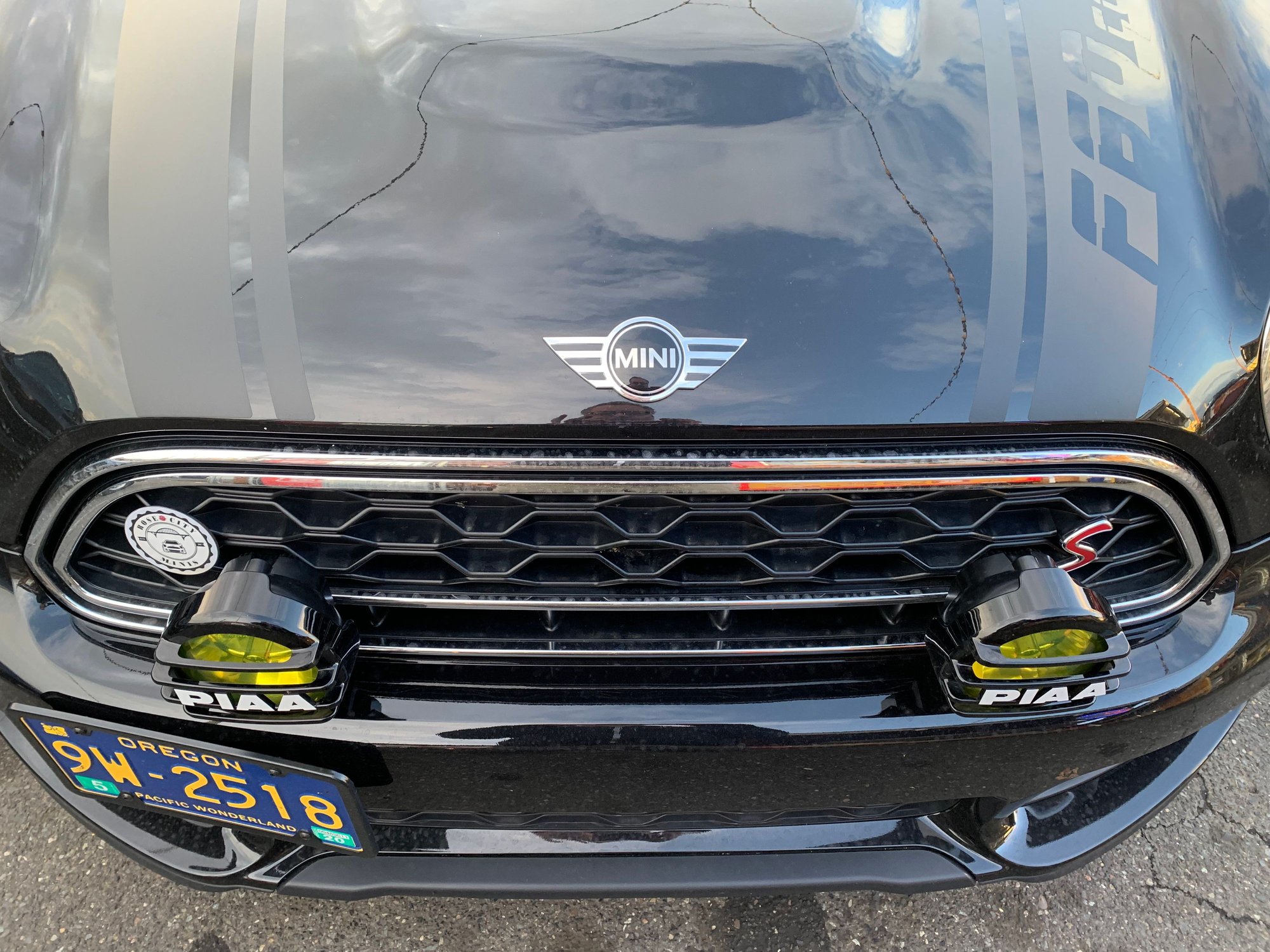

PIAA leds mounted on CravenSpeed Aux brackets. Uses the PIAA stand alone wiring harness and can be switched on independent of the MINIs headlights.
I've installed some of those Hella 500 lights and to be honest.. they're not of very good quality and the light output is mediocre at best. If they are just for looks, then they're just fine.
Steve, what model are those?
Old Oct 2, 2019 | 11:52 AM
StevePDX's Avatar
StevePDX
Joined: Aug 2016
Posts: 65
Likes: 45
From: Portland, OR
They're PIAA LP550 led white driving beam kit (item #: 05572). I added the yellow film.
