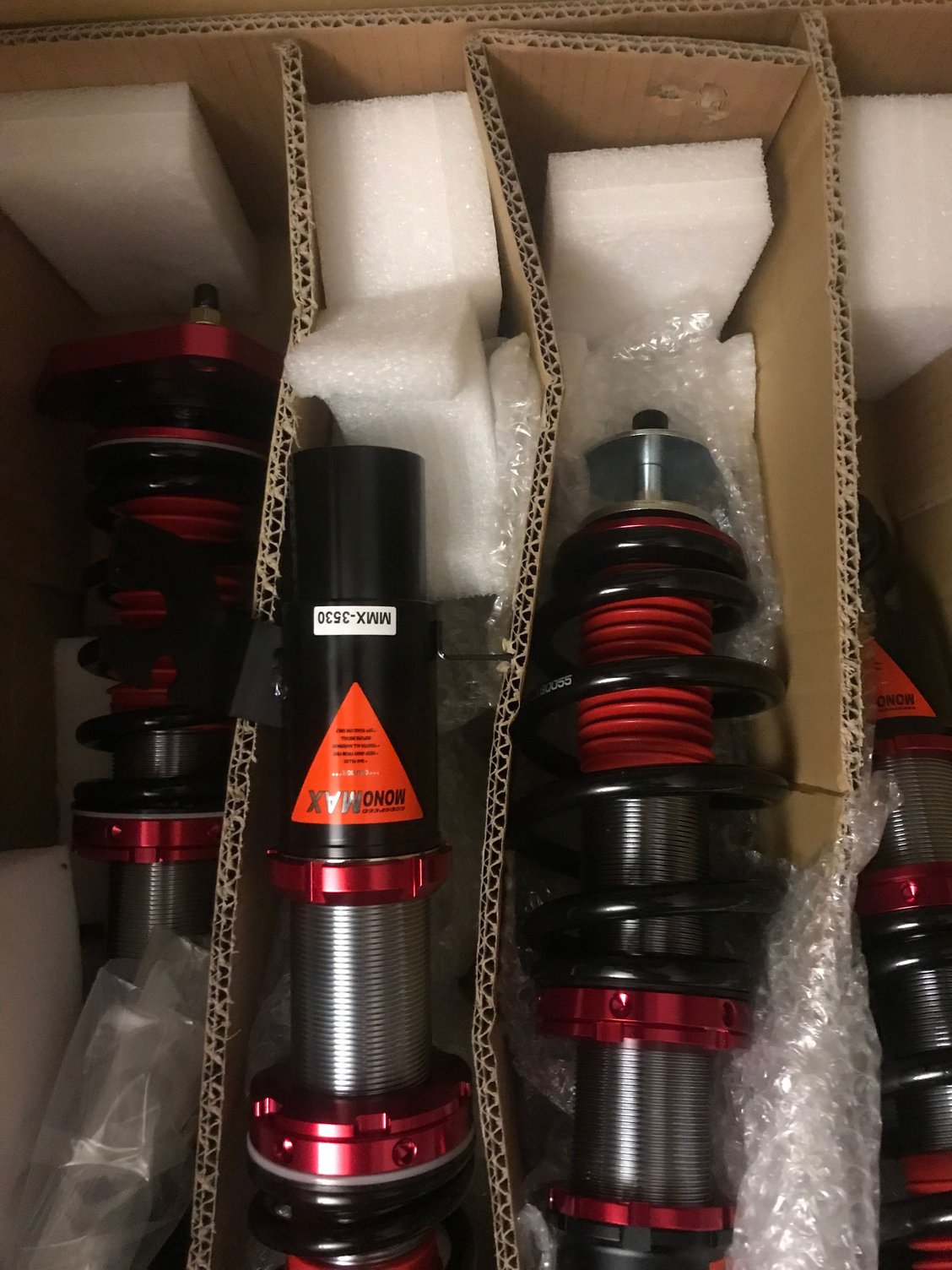

This just in
I got my Godspeed set today. Too late to start on it now but tomorrow morning I will be on it. They don’t look half bad. Tightened the bolts on the camber plate set to 0. I will adjust when they are on the car and I can see what’s going on when it’s on the ground. I extended the shock height to pretty much what I want it to be for the winters here. Once again I will adjust that when the car is on the ground.
