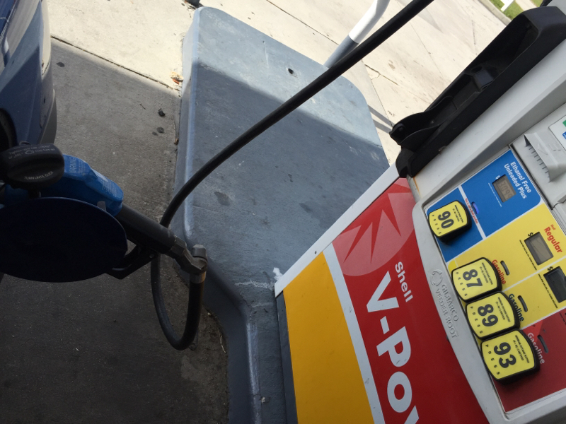

Fingers crossed.

Well, I drove around quite a bit today with the 90 E0 gas and thus far seems slightly different. I won't post what I'm noticing yet as it could be butt dyno.
I will say there is a subtle difference in sound. Not in a bad way, but I can't understand why. Maybe "deeper" sounding?
Also here are two videos. To me they sound pretty much the same. However, to the trained ear, you might hear something I can't.
1st with 93 Octane Sunoco E10
2nd with 90 Octane Shell E0
Thanks everyone. I'll keep you posted as time progresses.
