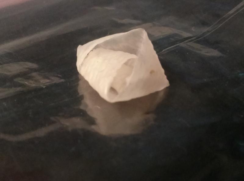

Picking my car up after a service visit, I found they left some silicone (that had come from the stack of numbers they use to label the cars in-service) melted to my dash under the August Sun.
I got it off with some patience and some goo gone.
I still have the silicone. Pic attached.
