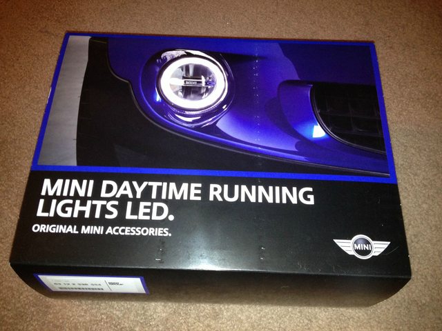

Oooooo... Look what I found on my porch this morning!
Check out the thread called MINI led fog light. There is another guy here that just got his yesterday too. Maybe you can help each other with the install for US cars?

It might take me a few weeks to find the time to install these things, so that other guy will probably beat me to it. But I'll see if I can't take some how-to pictures for any difficult bits I encounter when I do get around to it.
And... there are no instructions in the box.
Guess I'll have to go find that PDF again.
A pretty good DIY guide here:
http://www.totalmini.com/forum/18-20...ing-guide.html

Glad to see MINI going LED! I bought mine a month before these came out, that picture doesn't do them justice, they are crazy bright.
