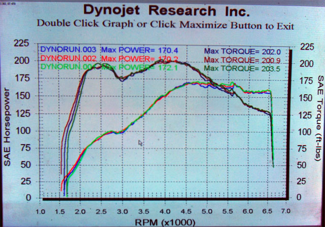

If you look at a dyno curve like, http://www.altaperformance.com/hardt...port-ecu-tuner
You will see that torque is dropping like a rock above 5500 RPM. So shift at 5500 ROM... or maybe a little later.

If you shift at red-line, you will at least be close to optimum.
If you want, you can plot out torque at the wheels at each speed in each gear. That's six plots on the graph; you would shift where they cross--if they do. If they don't cross, shift at redline. Torque in gear is engine torque at that RPM multiplied by the selected gear and R&P ratios, and by the overall tire rolling diameter.
That assumes you can shift gears instantaneously, which is not the case. So it is usually better to go a little higher than those intersection points, because the car will lose a little speed (more at higher speeds!) during the time you are off the gas. (No, don't speed-shift. It is truly not worth it.)
That's all too much work for me, so I say just shift at redline.

I have spreadsheet which does that for me. Using the torque curves I've seen pictures of out there, you shift at redline in first and second. Its only once you get to third you start shifting before redline, when you're getting close to 90mph.
