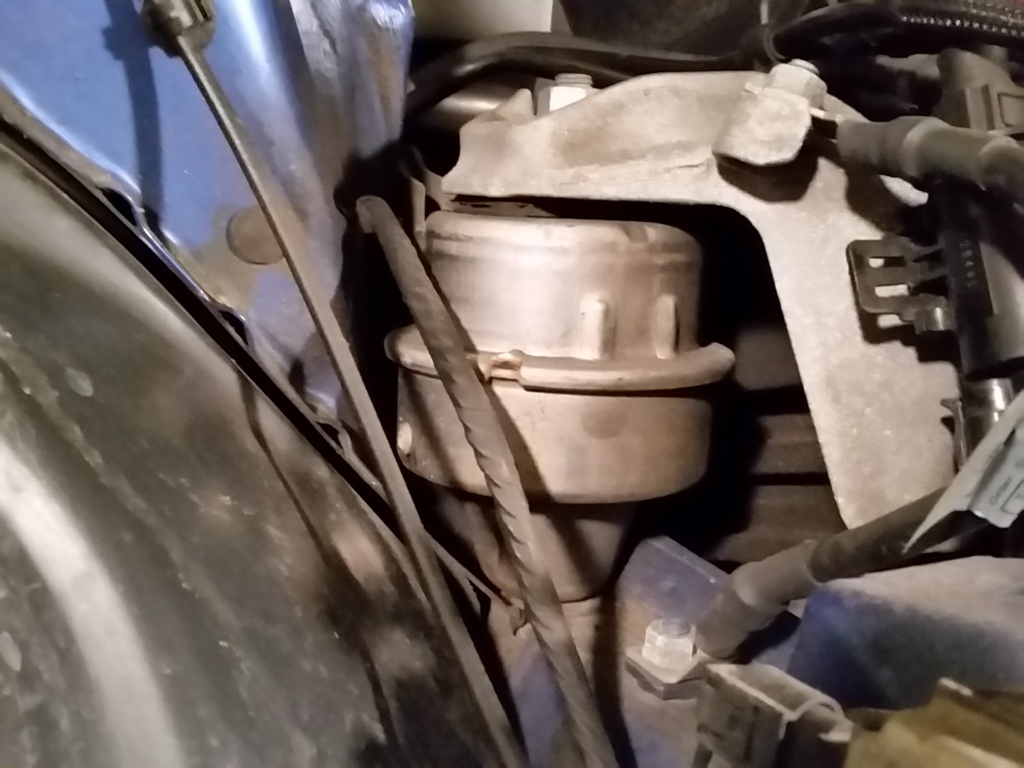

Yesterday I replaced the hydraulic engine mount.
It was a PITA because I rounded the bolt head that goes in the bottom of the mount. This was after trying 6-sided sockets on it and then going out to buy a set of star sockets. Didn't matter.
I ended up just pulling and pushing on the old mount until it broke off and then using an angle grinder to remove what remained of the mount. Then I used a hammer and punch to drive the bolt out through the bottom.
Oh the joys of working on older cars.

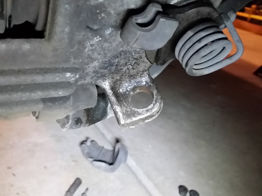

Today I'm working on removing the calipers because I want to get them powder-coated. This is new territory for me. I've changed pads and rotors before and solved issues with guide pins, but I've never disassembled calipers completely.
The challenge I'm facing right now is disconnecting the parking brake cables from the rear calipers. I discovered that the driver's side cable was rusted and seized and needs to be replaced. But the challenge is pulling the cable housing out of the caliper. On an older car like this the two components are frozen together. First I tried applying heat and pounding at it. Tried a hammer and chisel, which did create a small gap on the back side that I used to get an angle grinder into. Yep, had to just cut that flocker off. Unfortunately, I'll probably have to cut the other one off too, even though it is a good cable.
I found this thread to be helpful:
https://www.northamericanmotoring.co...in-an-r53.html

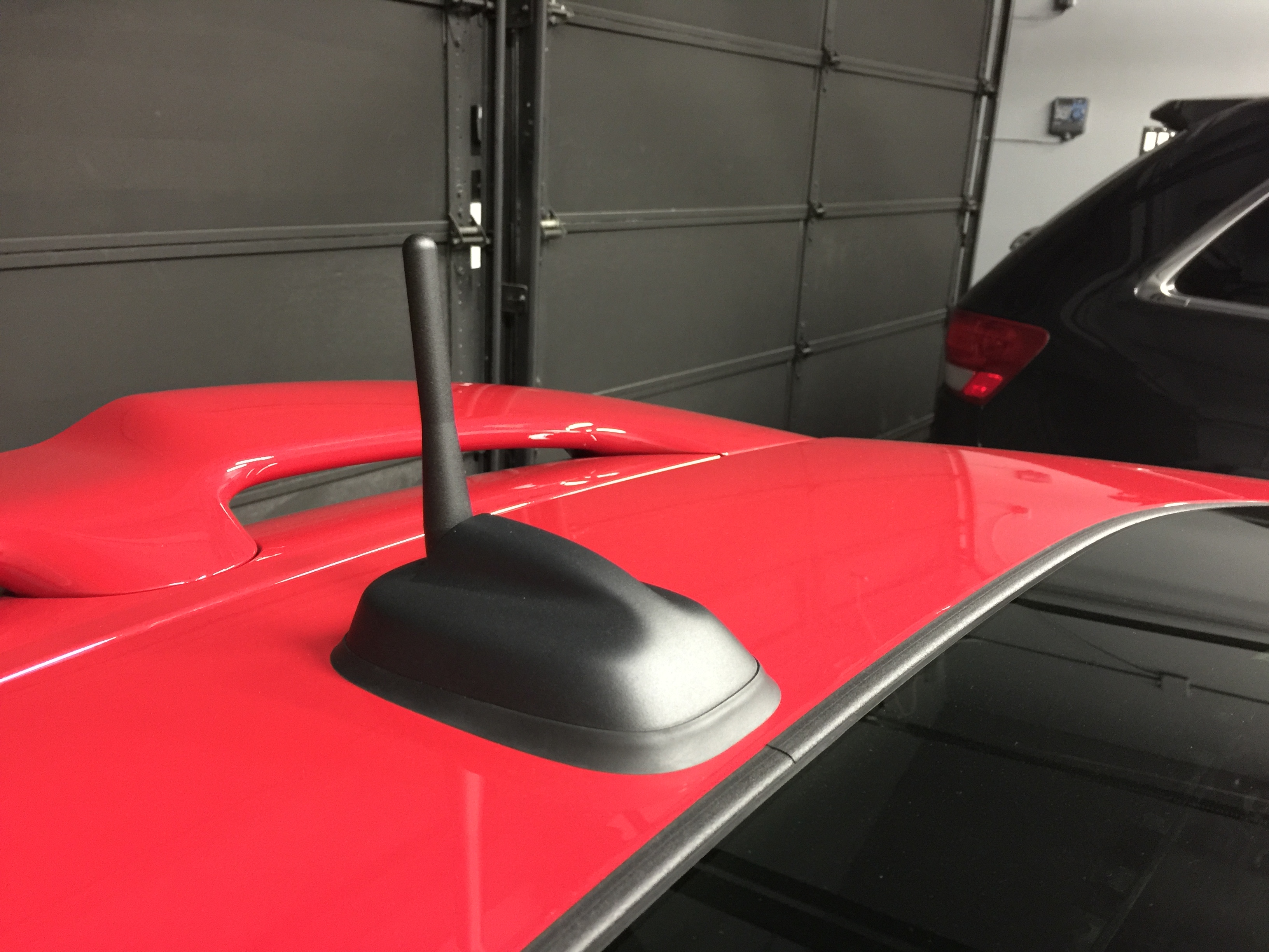

Added a stubby

Nice!

+1 yes a pain when they are rusted on. I PB blasted mine, then walked them out with a pair of pliers, Mine were bad , but did not need heated and chiseled.
Do both at the same time. Saves problems down the road.

Good job on the mount! The cables can be a pain after many years of gunk/brake dust build up. Spraying some WD40 on there to sit for a little to help. From a thread, "I used a pair of slip joint pliers to move the lever on the caliper enough to get the 'ball' out of the lever, then used a small drift and a hammer to get the cable out of the caliper housing." Although they're fine, after the years it's not a bad idea to replace them. Cables here if needed. Since you'll have it off and you're going to get it powdercoated you'll most likely need to take the boot off, in which case it may also just be a good idea to replace them while you have the caliper off. Boots HERE, one for both side (MINI doesn't sell the seal, just the boot). Let me know if you have any questions.
Congrats on the work. Well done.
Thanks guys!
I do have a question: Is it OK to leave the springs on the rear calipers when powder-coating?

Powdercoating is a baking process so I would recommend taking all things off of the calipers.
edit: Also, you most likely don't want to cover the springs in the powdercoating material as well. Just the caliper.

I would take them off. Otherwise they will be baked on and if you ever want to pop the spring off again it will be painted on. Tape off all moving parts before powder coating or have the powder coater tape off before paint.

There are rubber boots and seals inside those calipers, powdercoating isn't recommended unless you're totally disassembling the calipers. I would recommend using a painted on enamel paint such as G2 caliper paint.

Yeah, I understand now about the boots and seals. In fact, I've got my rear calipers fully disassembled and will do the same to the fronts tonight.
I have new boots and seals on order. Get rid of the old rubber.
I think I'm going to stick with powder coating. Seems to me that it's more durable. Plus, I don't trust myself to paint them. They would probably start chipping right away.
Thanks for the input!
