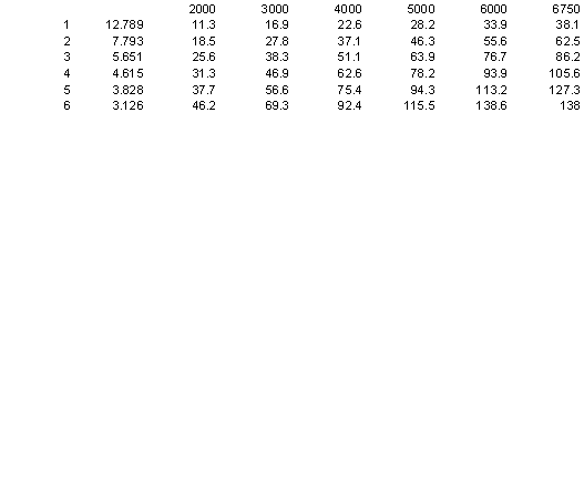

speeds generated at different RPM's for different gears. These are the ratios for an '06 MCS.
1 12.789
2 7.793
3 5.651
4 4.615
5 3.828
6 3.126
2000 3000
11.3 16.9
18.5 27.8
25.6 38.3
31.3 46.9
37.7 56.6
46.2 69.3
4000 5000
22.6 28.2
37.1 46.3
51.1 63.9
62.6 78.2
75.4 94.3
92.4 115.5
6000 6750
33.9 38.1
55.6 62.5
76.7 86.2
93.9 105.6
113.2 127.3
138.6 138
Attached Thumbnails RPM/Mileage question?-spdtab.bmp
