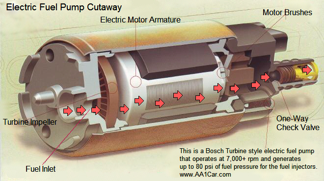

Is that car also direct injection with a high pressure cam driven pump? I'd be willing to bet that the small outlet from the pump is a bypass or pressure regulator relief.
Here is a cut away for a typical in-tank fuel pump:
As long as there is flow through the pump, the pump is being cooled and lubricated. These things can take much more abuse than you probably think.
But, you can do what you like. I have always run my cars down to the fuel warning light, and I've never changed a fuel pump either.
Just feeding fuel to the engine doesn't require much fuel flow. Even with a Hellcat running WOT it takes about 15 minutes to use at least 15 gallons. Tank capacity is just over 18 gallons.
But as I pointed out and while it is not shown in the pic/graphic some fuel is routed back to the tank to agitate the fuel and to ensure circulation of the fuel in the tank to maximize fuel pump cooling. The metal housing of the fuel pump presents considerable surface area to the fuel so this circulation of fuel carries away the heat. But of course their is a finite amount of fuel to absorb this heat.
I'm glad you have had good experiences running the fuel low. But I think there is some luck involved. That's fine. But I don't like to count on having the same good luck you have had so I'll continue to fuel up before the fuel level gets low enough to trigger a low fuel warning.
