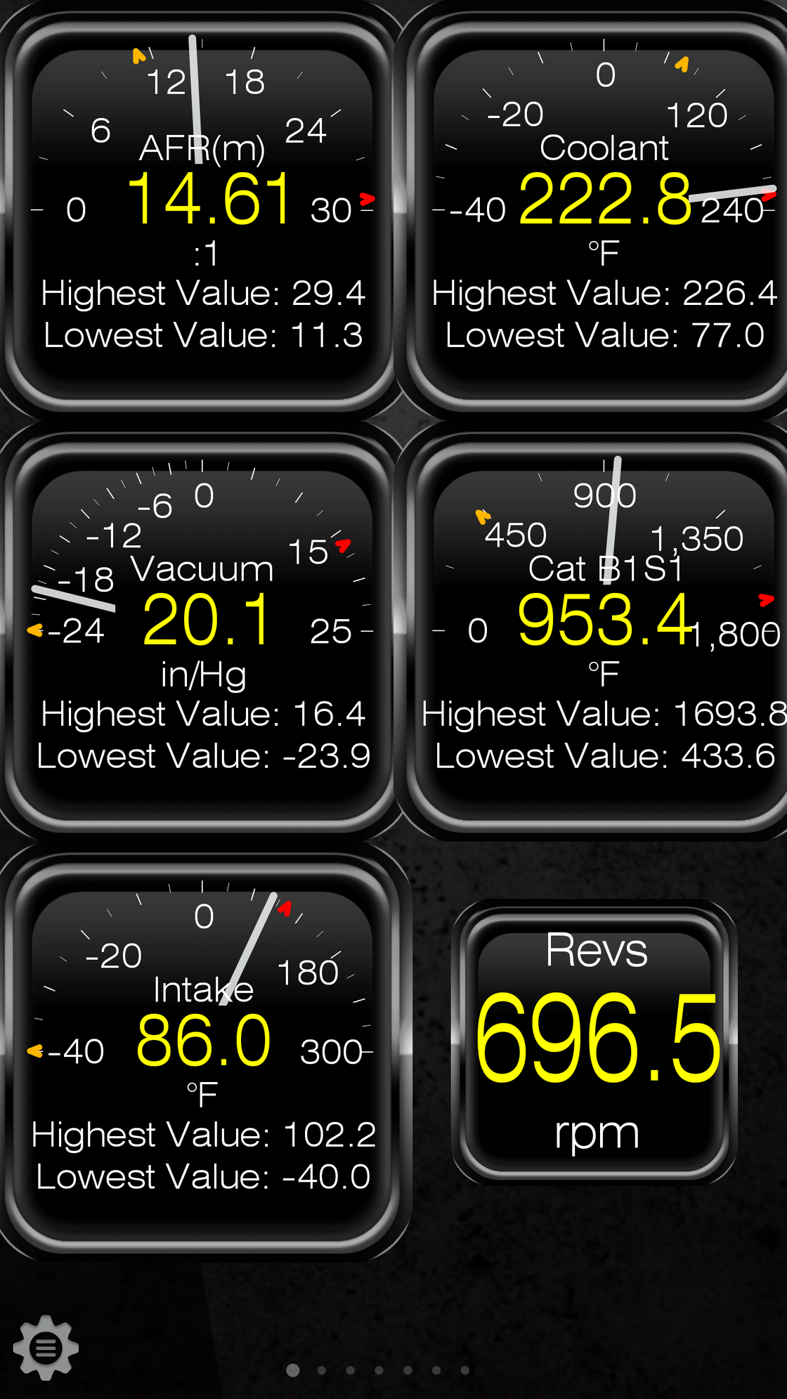

*Curious if anyone else is running ethanol or meth, what your AFR looks like around 6k @ WOT?
[min/max shot from this mornings commute; 75% throttle 3rd gear pull @ 16psi & ~12.0 AFR] full log attached for reference
*pulled some data from the return trip.. AFR 11.2 - 12.0 @ WOT 2,3,4
