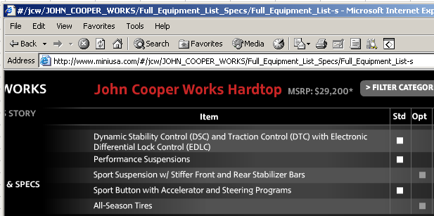

I just saw this on the Mini USA site. Makes me mad at my MA who told me it was not an option.
Attachment 37083
Unfortunately, there are a few things that show up as available on the MINIUSA configurator that aren't really available.
I saw that JCW options table and asked the sales manager about the All Season tires after being told they weren't available. He said it was a mistake & that they really are not available from factory for the JCW.
