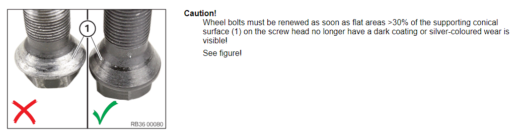

This item is guidance from TIS: "Wheel bolts must be renewed as soon as flat areas > 30% of the supporting conical surface (1) on the screw head no longer have a dark coating or silver-coloured wear is visible!"
So 2 questions.
(1) Are you paying attention to this and are you following this guidance?
(2) If you replace your lug bolts with aftermarket, how do you translate this wear monitoring rule for whatever aftermarket part you're using?

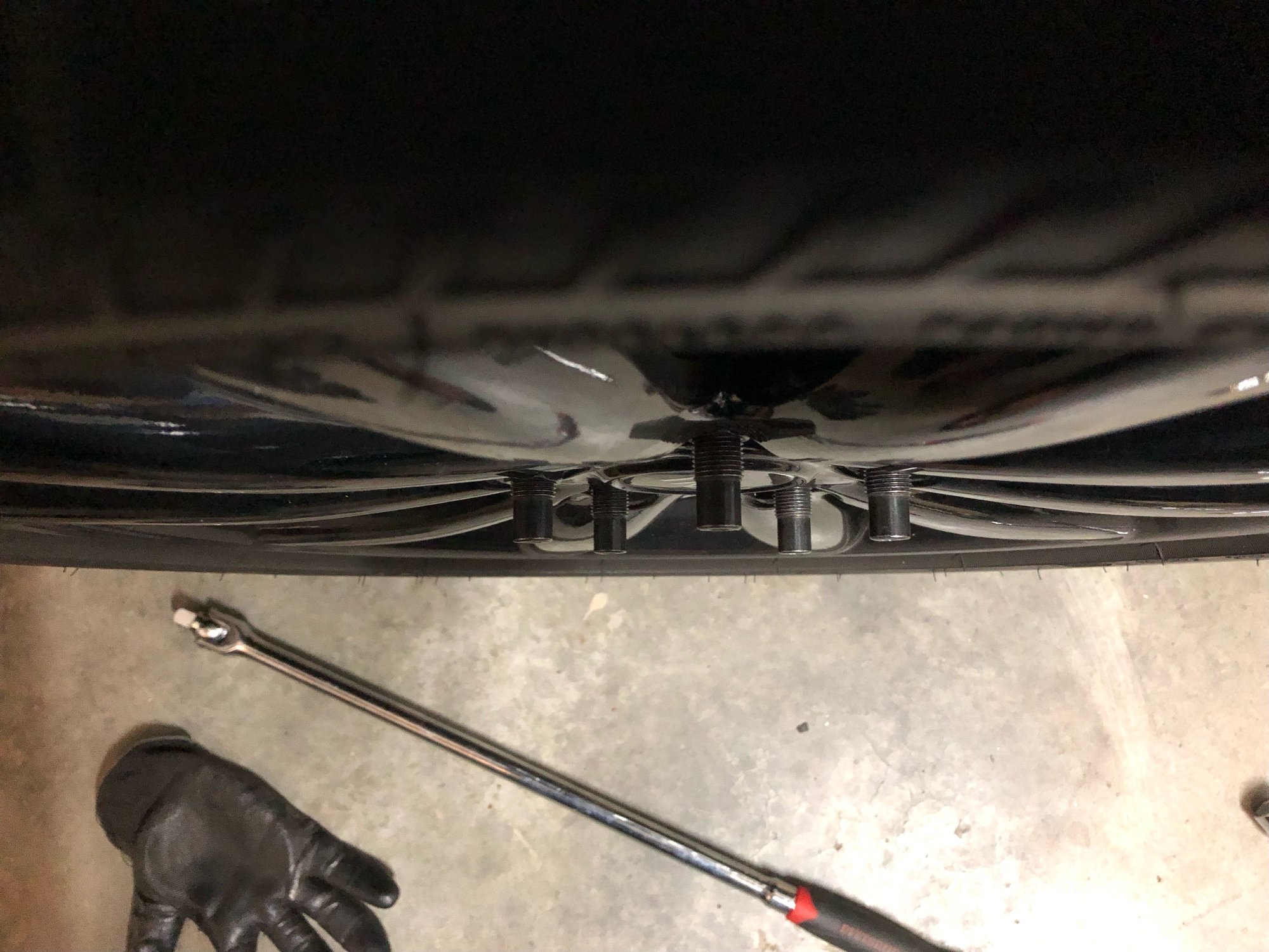

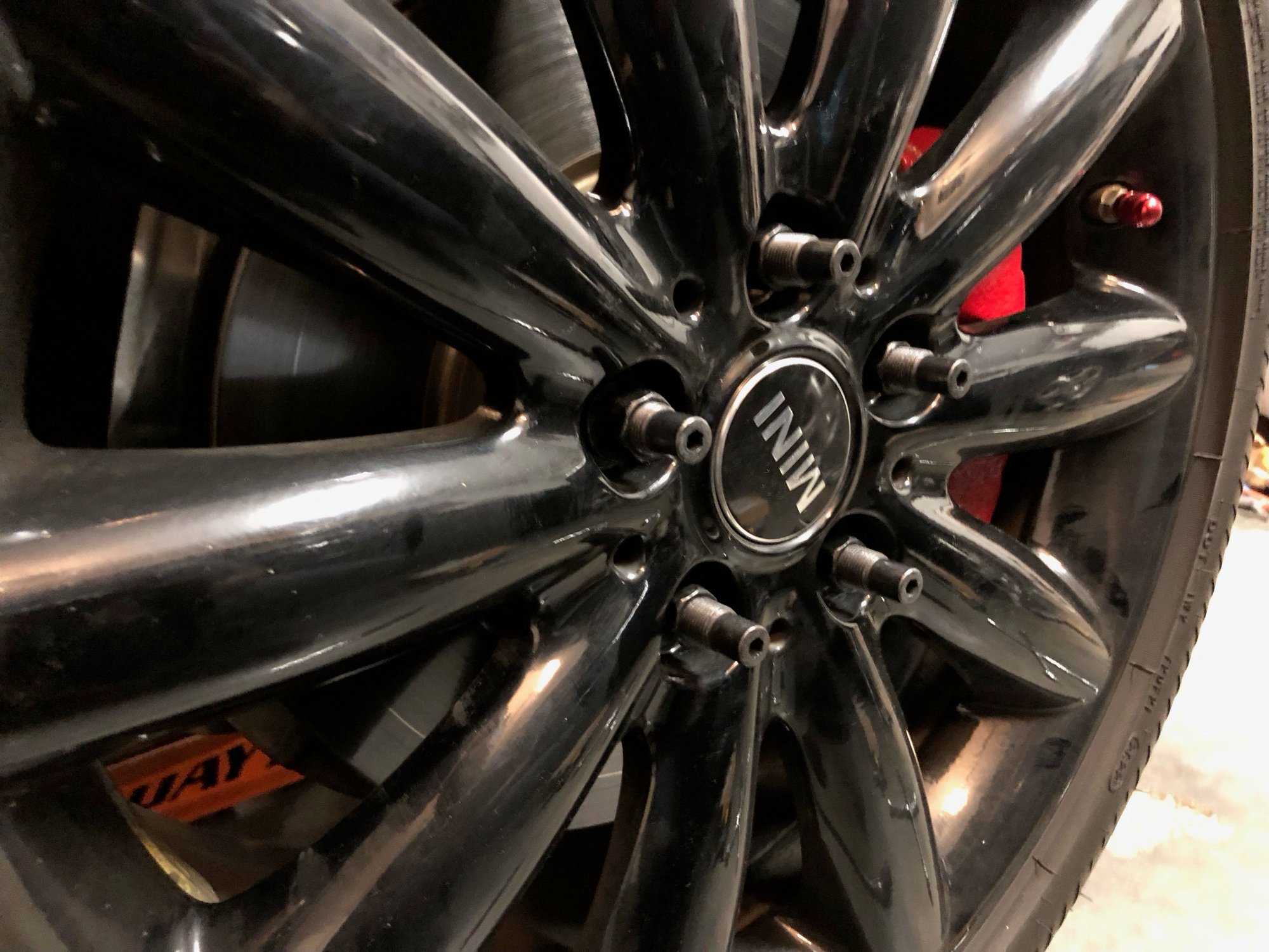

Sanity check me here -- I'm doing install right now.
From the link:
Notes
M14x1.25 (BMW/MINI)
STUD
Stud ø: 14mm
Thread Pitch: 1.25mm
Overall Stud Length: 75mm
Exposed stud Length: 55mm

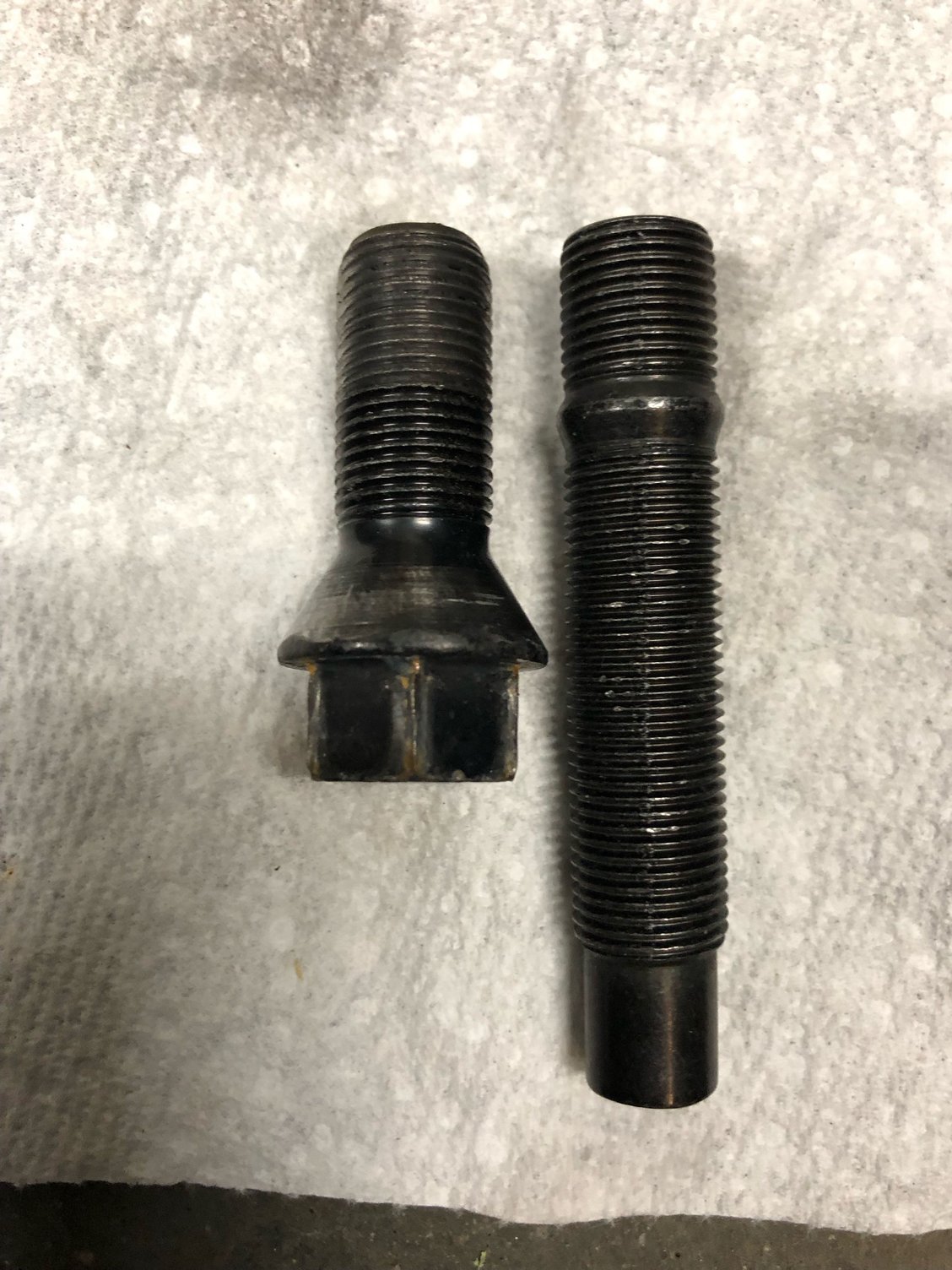

The full length of the factory lug bolts on my F56S is 46mm. So the exposed stud length is going to stick out a bit here, by about 9mm, and I can absolutely see this difference. Measurement backs up the stated overall stud length in the spec above.
@johnnys2quick , @njaremka , this sound ok / match your experience?
Pics:
Installed, studs threaded in as far as they'll go (short end before the knuckle in -- the long end is way too deep and the wheel definitely wouldn't spin freely), nuts hand tight
View from above showing stud extension beyond wheel face
Factory lug bolt (46mm) vs stud length (75mm)

Looks right to me. Studs are typically longer to ensure you get the correct nut torque, and so you can run spacers. Those look like they will handle a 15mm spacer.
