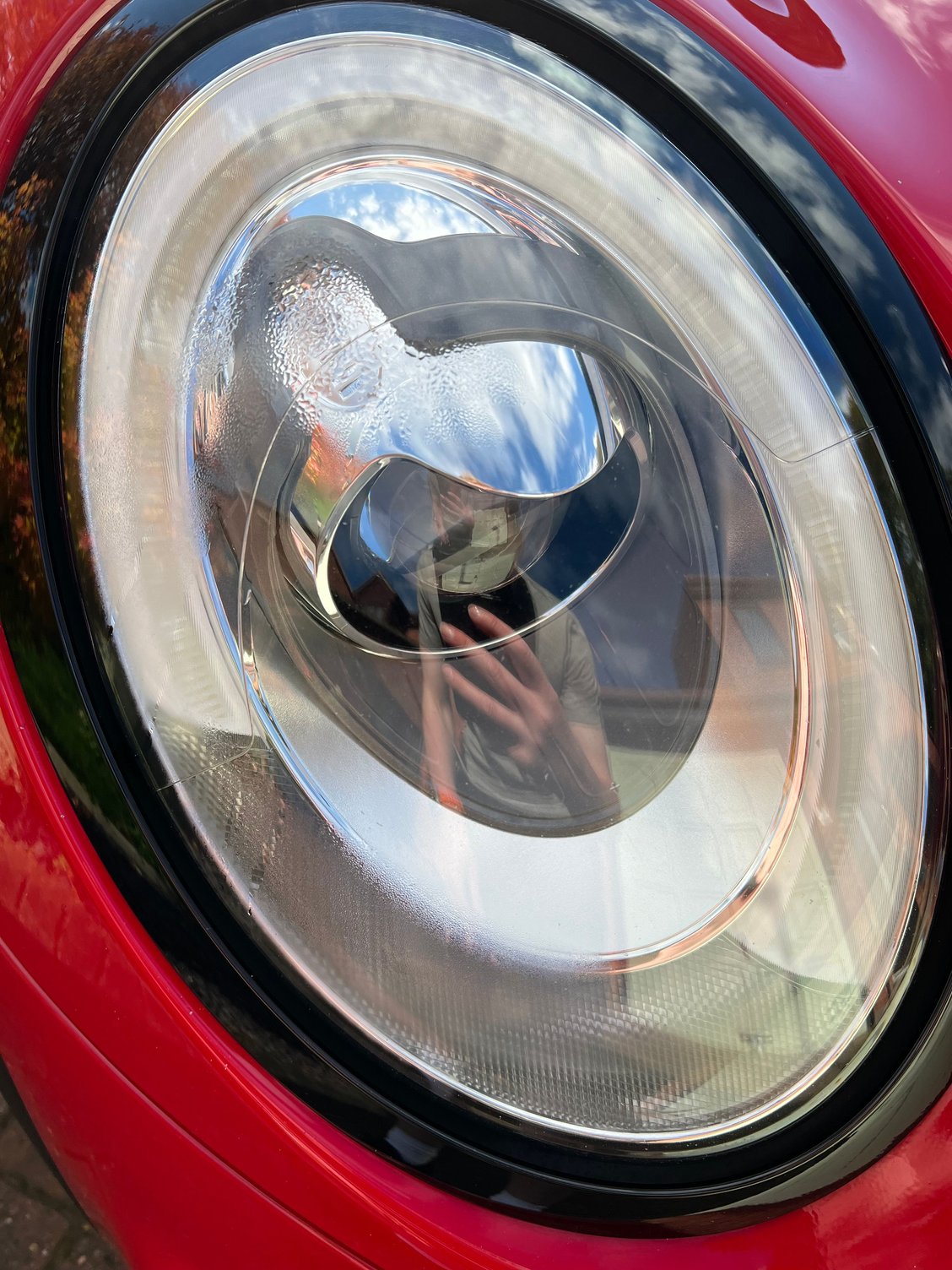

After washing my car today I noticed moisture / droplets on the inside surface of the headlights.
Anyone else suffer the same? To be expected?

Yeah it’s on both headlights - definitely worse after washing. May have been there before and just not noticed or given any thought to it.
Not cleared despite going for a drive with lights on.
The manual states some mist / condensation is normal but these seem to be droplets.

Yea thats heavy moisture. I have only seen the HL crack like this. First one i have seen with heavy moisture. We have some of the early designs from valeo on super sale, otherwise you have to dry them out and make sure the little vent hose on the back of the headlight is open

Still some moisture on the bottom lip of both headlights in the same location - could be related to with the wet / humid conditions and cool nights experienced here in the UK at the minute?

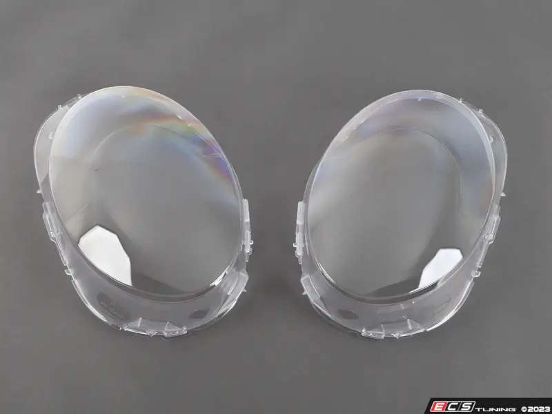

If they dont, I would dry them out and get the new lenses. That way you can take them apart and replace the lens, wipe them out. That way it will not spider as you have a new lens.
https://www.ecstuning.com/b-bremmen-...ies-bzf56~brp/

^^ These just landed in the headlight lens, so people that have the cracking can replace just the lens.
