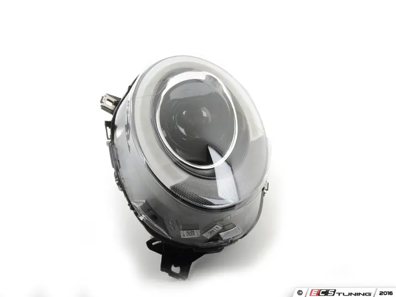

First time i have seen that in the F56. Seen the halogen ones fade. The factory Valeo ones pre LCI we have cheap now. But you need LCI.
I dont think pre LCI will hook into LCI as a straight swap.
I dont see Valeo or AL(magneti Marelli) OEM supplier release to the aftermarket yet. We don't have aftermarkets for factory LED cars. Just genuine.
pre LCI
https://www.ecstuning.com/Search/Sit...h/63117448386/
and
https://www.ecstuning.com/Search/Sit...h/63117448385/
Old May 25, 2023 | 09:56 AM
Posts: 36,766
Likes: 2,552
Just found this also, so LCI swaps into PRE LCI, so with programming, Pre LCI should swap into LCI. That means those valeo units on sale should work in newer MINIs.

Valeo and AL are OEM dependent on the year and type. In the aftersales they are not allowed to print "MINI" on the inside of the headlight for the Gen 3 MINI. So thats is blank unless you purchase the Genuine MINI headlights.
Programming means to flash with NCS expert or hack software,

Linked above are the headlights and super cheap. 1/10th the price and OEM, just dont say MINI.
https://www.northamericanmotoring.co...n-pre-lci.html
Why would someone downgrade to pre-LCI headlights?????
Old Jul 6, 2023 | 05:59 AM
Posts: 36,766
Likes: 2,552
They like the design better then the LCI, also the pre LCI through valeo direct is much cheaper, look at the prices linked above. Especially if you are out of warranty.
