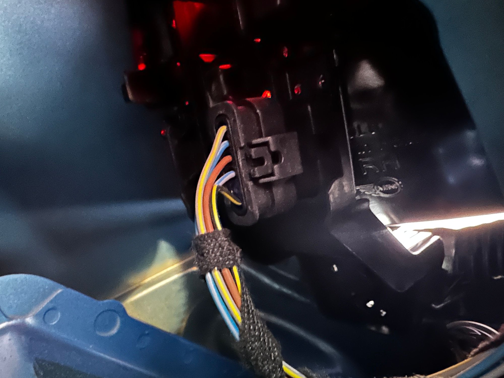

Reverse light wire color for F56 2016 Mini North American
Can someone please guide me as to what is the color of wire for the reverse light on F56 2016 2door 1.5 LTR engine, hardtop North American. I’m trying to install a reverse camera from Seicane which is just a regular reverse camera that I need to wire to reverse light wire. Please help. Thank you all.
Based on wiring diagrams I can find:
Left side: Grey/Blue (pin 4, 6-pin connector to tail lamp assembly)
Right side: either Grey/Blue or Green/Blue (either one color pair or the other, pin 4, 6-pin connector to tail lamp assembly)
The other ends of both wires are at the Body Domain Controller (separate pins on one BDC connector, these two wires do not combine to a single point before the BDC).

This image is for the driver side back light and purple wire is on the top side of the connector. Same question, which wire is for the REVERSE LIGHT to install a rear camera. My earlier post has the same question and has the image of the passenger side rear light in which yellow wire is on the top side of the connector. Thank you all in advance for your support. I really like this forum 😊

@rubeenc , unplug your connectors. The pins are are numbered, but the numbers are on the end of the connector that is jacked into the lamp assemblies. You will not be able to read the pin numbers on the connectors without unplugging the connectors.
Once you have unplugged your connectors, see what color wire is connected to pin #4 of each.

@cjv2 Thank you so much 😊 I’ll unplug the connector and look for pin 4 on both sides and connect the rear camera’s hot wire in to these pins. I really appreciate your help. Thank you again 🙏🏻😊
One thing. Well, three.
(1) You probably only need to connect your camera to one of those two wires. When you put the car in reverse both lights come on. As long as neither bulb is burnt out, that means you really only need the electrical connection of one of them as signal (which is what your rear camera is going to be looking for to "know" the car is in reverse).
(2) There are a lot of reports of the left plug/assembly overheating and melting the plug. Seems to be a design thing and when it happens all the heat/melting seems to be at the ground pin (pin 3). So given a choice between left side and right side tinkering, I would leave the left side alone and tinker with the right.
(3) Given item (2) even the right plug's electrical might well be, shall we say, "sensitive." So be very precise and careful, maybe more precise and careful than you might be otherwise, to ensure that electrical connections remain as good as possible.

@cjv2 you made an important point here, I really appreciate that as I wasn’t aware of it. Can you please clarify when you say the left side, dees that mean when facing the front of the vehicle and looking at the left side which would be the passenger side (North American) models and right would be the driver side? Thanks again.
Left and right are as-marked on the vehicle.
See the first of the two photos you posted: the lamp assembly in the photo is clearly marked "RH" -- as in "right hand" -- as in right-hand side.
You won't find these markings on all parts in the car. But when you do find them, things marked "LH" or "L" will consistently be on one side of the vehicle, and things marked "RH" or "R" will consistently be on the other side of the vehicle. These in turn correspond to "left" and "right" on literally any documentation you will ever find about the car, its manufacture, parts for it, or its operation. There will never be a variance.

@cjv2 Wow! Perfect and clear explanation! I just have to remove the connector and look for these markings. Thank you again 😊
