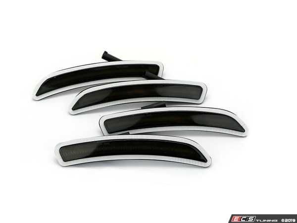

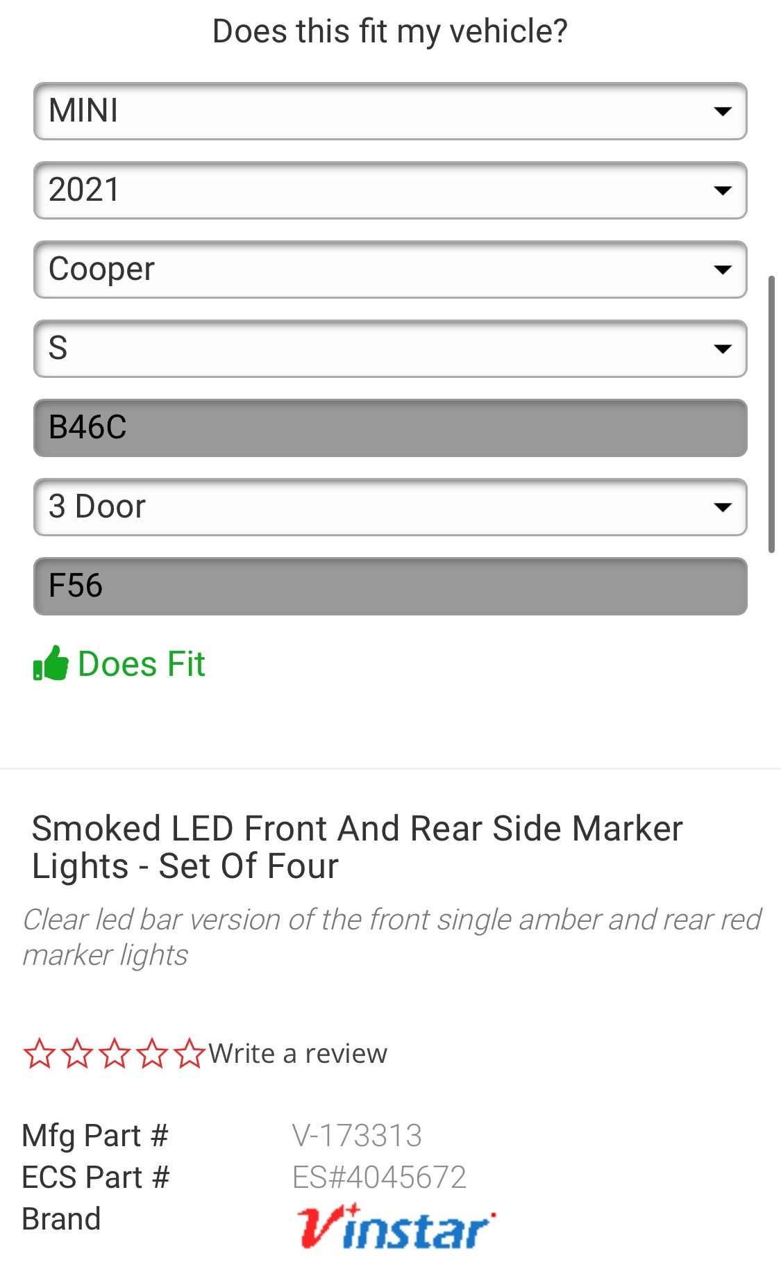

I’ve used Vinstar LED side markers on my ‘14 and ‘19 Coopers. The LEDs were bright and didn’t fade or burnout over time. Yes, the adhesive was a pain and at the time I had no access to a heat gun.
My question to the group: Does anyone know of a company that has them for the 2021 Cooper?
While searching most companies list the compatibility as ‘14-‘19.
I did purchase another Vinstar set from ECS Tuning which shows as compatible but I had to return them because the OEM connection wouldn’t insert into the new socket .

Yes these are the 14-19: https://www.ecstuning.com/b-vinstar-.../v-173313~vin/
Can you show me the connection on the 2020+ ? Did not know the 2020+ changed. MINI likes to change things on us all the time and now the 2020 updates dont show on the etk all the time.

Hi ECS Tuning,
I don’t have a picture of the inside of the connector at this time, however, when I install the rear splitters next week I will take one
It does appear that MINI did change the inside of the connector starting with the 2020 models because all the third-party companies that make the LED side markers only have them listed up to ‘19.
If possible the fitment for the Vinstar LEDs should be changed to “does not fit” on your website since I purchased them and verified they do not fit. This can also help other ‘20 and ‘21 MINI owners with their purchases.

Yes, we update that when confirmed, you are the first person i have heard of that says it does not fit and we want to make sure its not an issue. I need to see the plug and weed out it was not an install error.

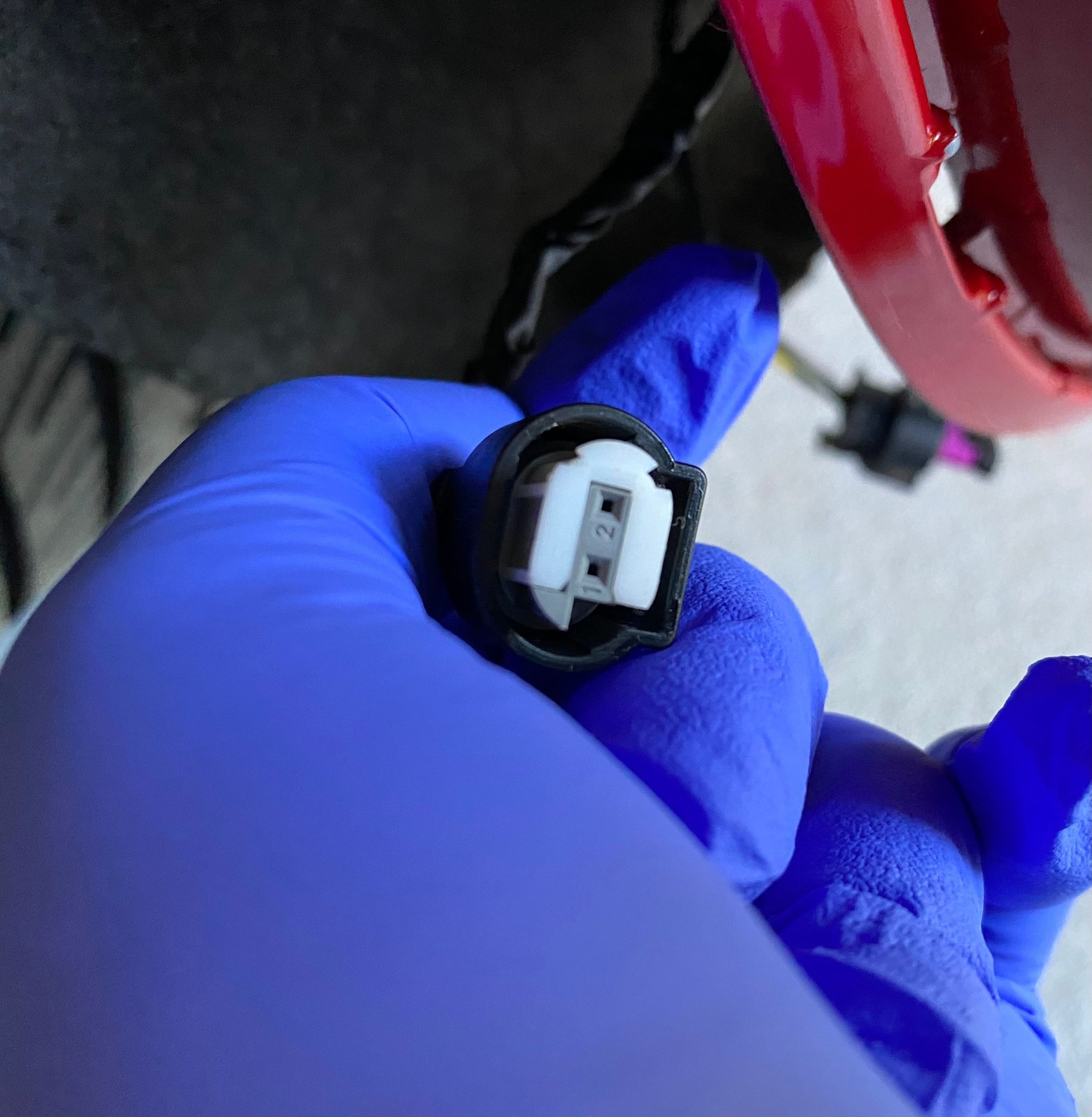

Hi Mike and the ECS team,
Here’s the side marker connection on my ‘21 2DR HT S.
When inserting into the Vinstar side marker LEDs it would barely go in and there was resistance near the corner where the number one pin is.
Inside the Vinstar connector there’s a small alignment bracket/square that would stop the MINIs connector from fully seating.
If you zoom into the corner of the number one pin you can see the mark it left when trying to firmly insert it and it only inserts in one direction.
I hope this helps your team,
