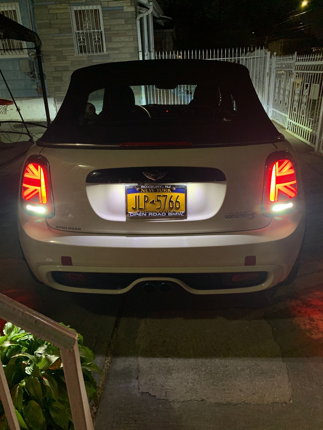

How you guys doing? Just putting this out there to see if anyone had the same issue and how they resolved it. So I have a F57, 2017 Cooper S, Convertible with the Halogen lights. I just purchased a pair of European Tail Lightshttps://www.ebay.com/itm/BMW-MINI-OE...72.m2749.l2649. After installing and Coding, the error on the dash went away, but the tailights doesn't light up. The turn signal works and the brake light works, but I cant get the Union Jack to light up, I followed all the directions to code it, and it's still not activating. Did any of you guys had that issue? and how did you resolve it?

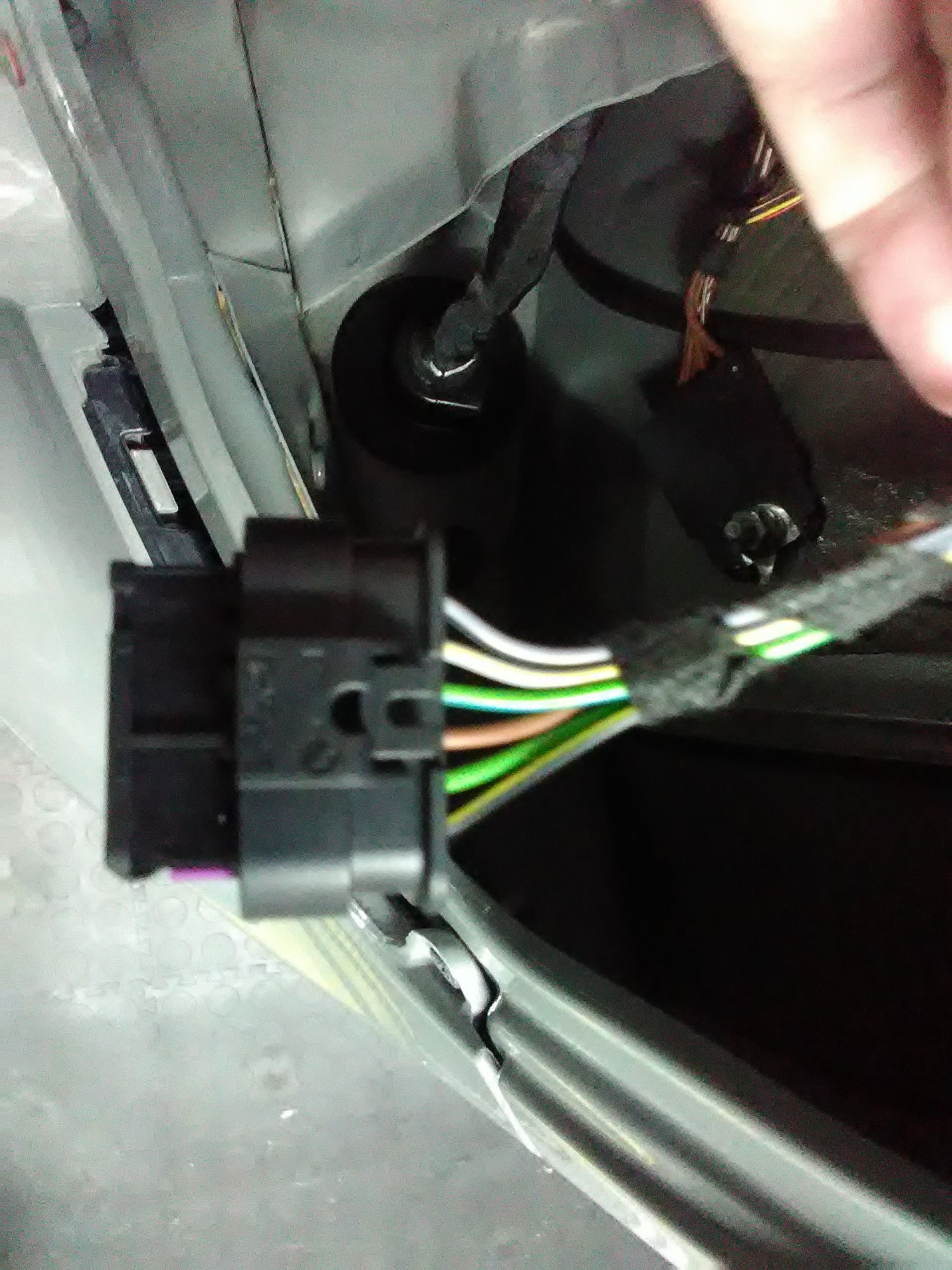

Originally Posted by gtbrooklyn
My problem is my sidelights are not on. So I am not sure if I need to repin 1 to 5 since I am going from strictly Halogen to LEDS.
Have you tried with the light switch in all positions?
If you have 6 wires to each connector you don't need to swap the pins but if you have 5 then you do
6 wires

Union Jack Tailights now working.
So a quick update. I finally got them working by switching pin 1 to 5 and coding out the errors
Big shout out to Robby71 and DunkM. They were a valuable source of help to me. Thanks again guys. This is one hell of an upgrade.
