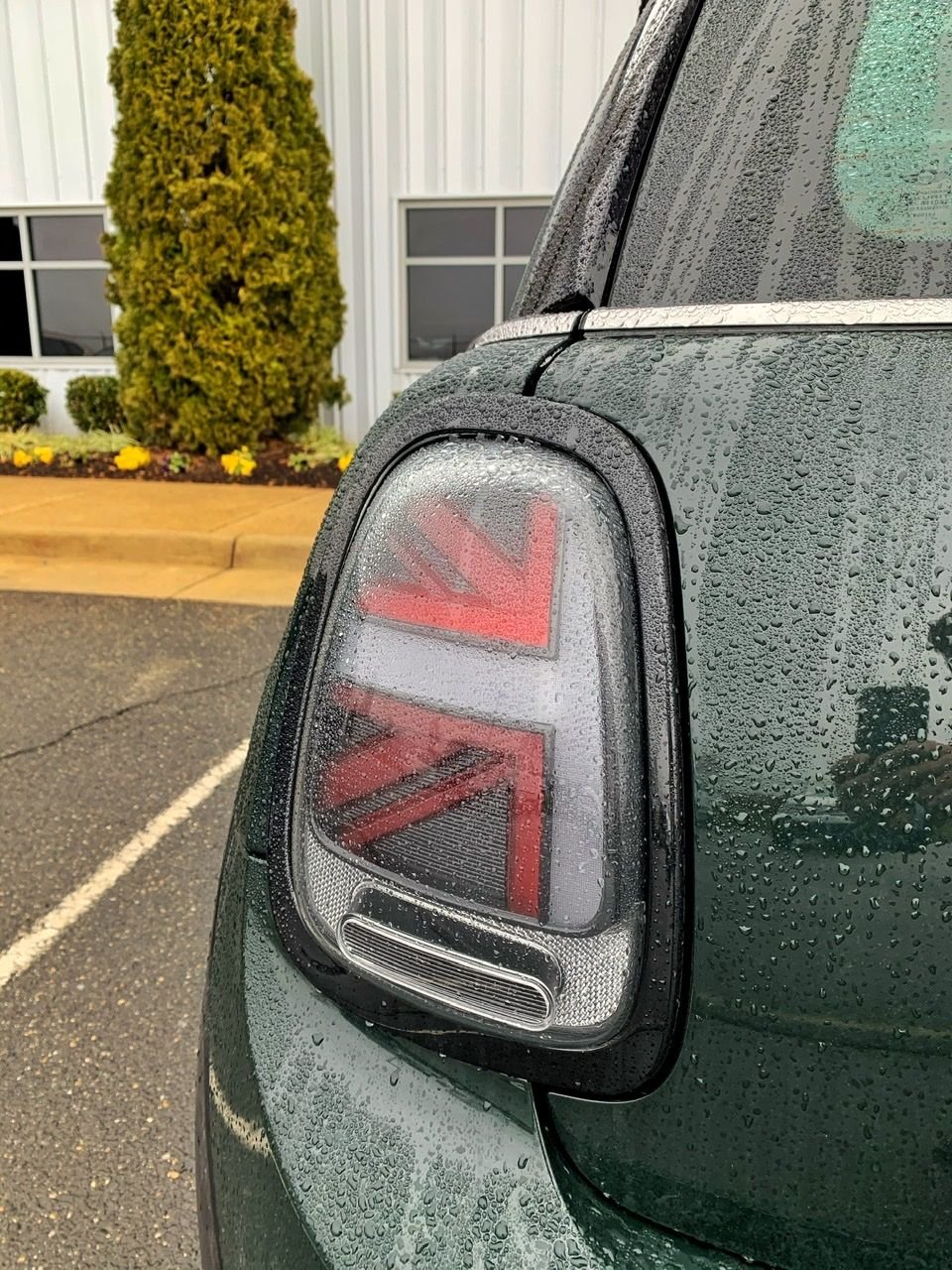

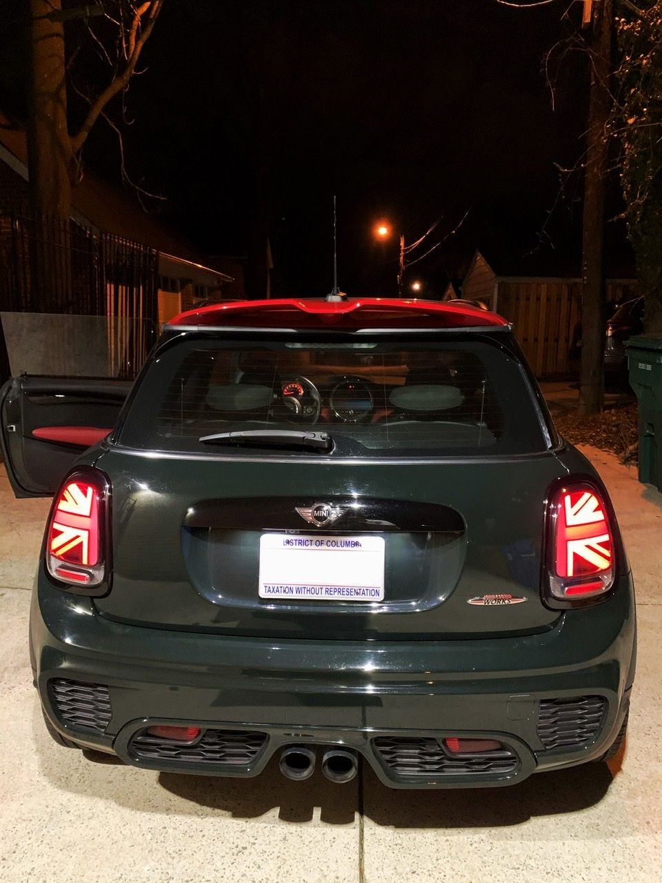

Ordered these for $250, they came last night and got installed. Work amazing and look great, the turn indicator is the dynamic swiping Audi style.
https://www.banggood.com/Car-LED-Rea...r_warehouse=CN
If you sign up for a new account there are coupons around for $20-25 off your first order if you search around. Ended up getting mine for a total of $230 INCLUDING SHIPPING!

Sorry for the poor lighting, put them in late last night.

I did the “clear/red” option. Some more daytime pics, albeit with rain!
