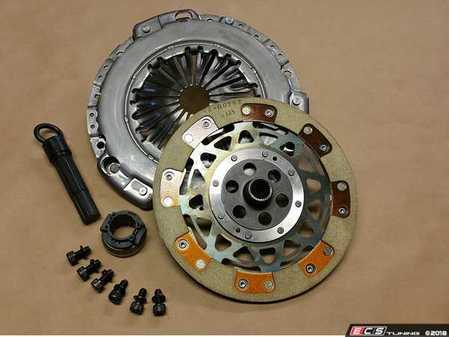

I upgraded to the Helix organic clutch and SMF kit from Lohen. Took some time to get it through customs and into the US. Personally, I don't find the clutch to be too heavy at all and I daily drive the car around the NYC area. It has a noticeably stiffer pedal feel compared to the stock setup, but I got used to it very quickly... to the point where I've described it as having an almost OEM pedal feel to friends (but they've disagreed with me )

Went with the Lohen organic clutch kit by Helix that'll hold up to 500nm (370ft lbs). Ordered it on Saturday afternoon and it arrived from the UK on Tuesday. Saving up for a Wavetrac differential before tackling this.

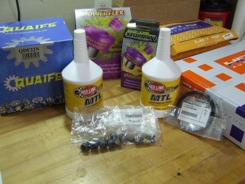

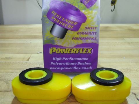

Just finished upgrading mine with the Helix Clutch kit from Lohen, Quaife LSD, and PowerFlex control arm bushings and lower motor mount. I was pretty impressed with how quickly it arrived from across the pond, and how well the parts were protected. Had a Valeo kit for my daughters R53 that was just dropped into a box w/ a piece of plastic, wasn't happy with that one. Granted, you will get an import duty from Fedex (or who completed delivery in US) but was about $35. Did the install myself and took video of the process (not sure how that is going to turn out).
I am no mechanic or automotive technician by any stretch of the imagination. Completed the install last week, but after a test drive figured I must have done something wrong. The clutch was super grabby in 1st gear and reverse. So, took the transmission back out to recheck, and also installed a new slave cylinder. Still real grabby in 1st and reverse; but figure I need to bed the clutch in and get used to the single mass flywheel vs the dual mass. Pedal feels good, and I'm not smelling the clutch burning, so figure I'm good to go. Man, took the car out and barked the tires in 1st gear w/out even trying.

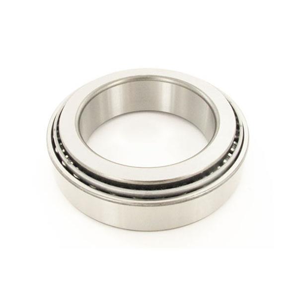

What differential bearings did you use?
I bought mine from Way Motor Works here is the link.
https://www.waymotorworks.com/differ...6-f57-f60.html

Yeah...I noticed he hid the part number on the bearings so I can't cross reference them. I don't blame him though. It's been difficult to locate the proper part number. I did find one thread on here and he posted the part number for the race and not the roller bearing assembly: LM503310
It could be this Timken part number but I'm not comfortably sure.
$22 each on Amazon $22 each on Amazon
and the SKF Version from Summit for $23. I should just stop being cheap and buy it from Way and be done with it.

Ok- got my order from Lohen- Helix clutch kit and Quaife LSD. Also opted for their install kit, which included fluid, a few seals and bolts. Thanks folks here for the info & recommendations. Went with Helix as it includes a somewhat lightened flywheel, but priced a few hundred bucks less than Clutchmasters. I guess Lohen worked with Helix on the design / specs, so I felt like they probably knew what they're doing. And it appears Lohen installs an awful lot of them.
Took about 4 days to arrive from the UK. Brought it all down to Jan @ RMW in Anaheim. First catch- the clutch didn't come with an alignment tool! Kinda silly. Would sure save a lot of headaches to just toss that little bit of plastic in there!
Anyway, now it's in, and a couple hundred miles on the road. I love this clutch! Pedal feel is slightly LIGHTER than my stock S. Engagement maybe slightly higher, dunno if this will change because it's not self-adjusting? Anyway, not an issue. Drivability is so much better than stock. I didn't realize- the stock clutch disk is solid, not sprung. The only dampening is the rubber on the stock dual-mass flywheel. Which basically sucks. The Helix has the typical metal springs on the disk. Engagement is much, much smoother than stock ever was. Both from a stop, and between gears. Less lurching. Less drama if I don't perfectly engage. Just so much better.
It holds my power no problem. I'm on a stage 1 tune with IC & exhaust.
And the slightly lightened flywheel is very welcome too. It's easier to rev when engaging, and more responsive between gears. It's not a night-and-day difference like an aluminum flywheel, but just feels really, really natural in the car. This is how it should have come from the factory. The clutch now simply gets out of my way, and lets me drive the car well. That's probably the best you can ask of any clutch.
