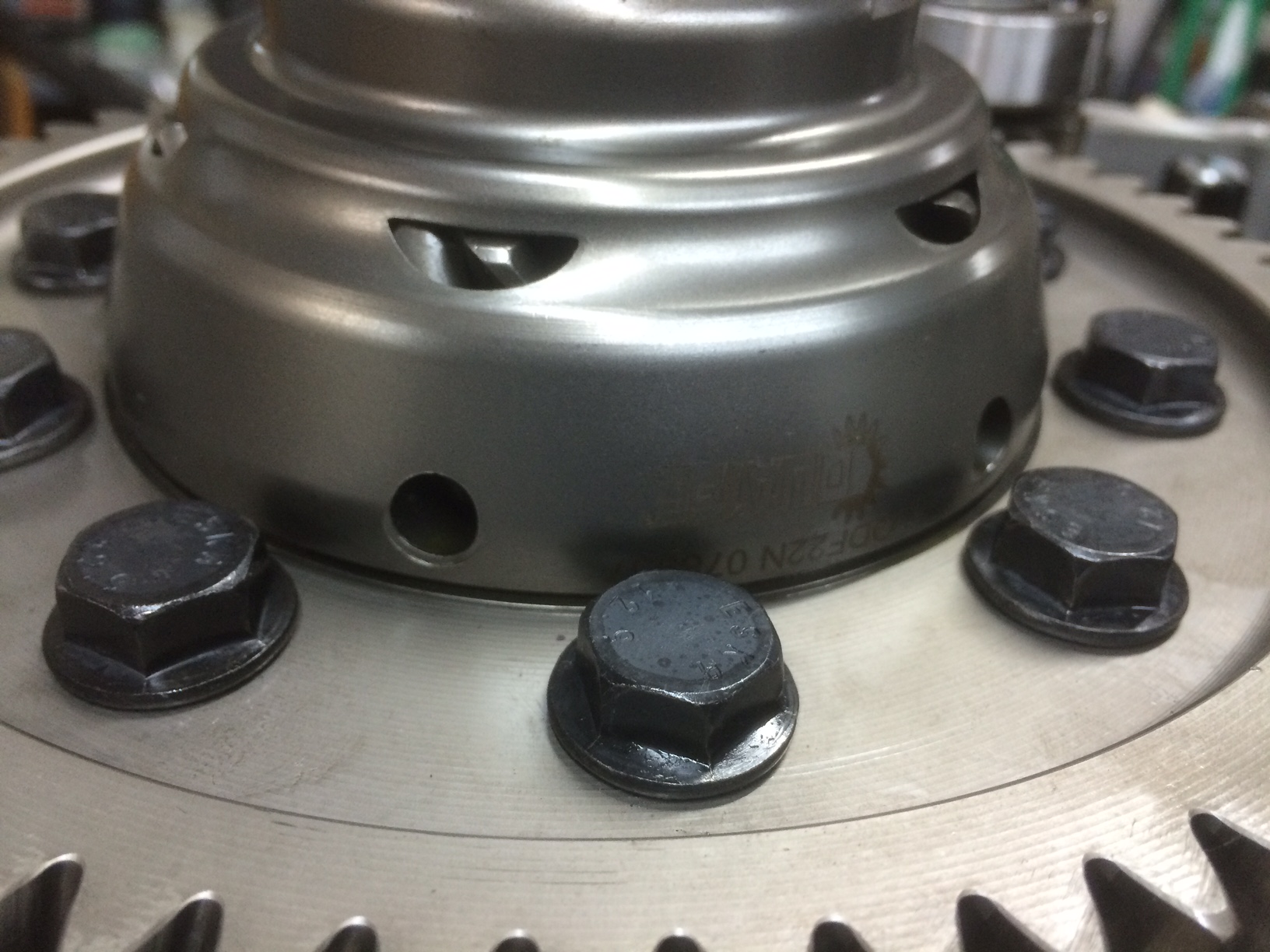

install pics
Tech took a couple of pics of the Quaife and the original open diff.
Attached Thumbnails Anyone add an LSD yet?-img_1593.jpg   Anyone add an LSD yet?-img_1594.jpg   Anyone add an LSD yet?-img_1595.jpg

Finally, I could have the time to make a LSD DYS swap.
I took most of the info from here: https://www.newtis.info/tisv2/a/en/f...-transmission/
I did not have the PN of the bearings so I decided to remove the OEM ones and purchase a new ones in a local parts shop.
Most important info: both bearings are the same and the brand is KOYO LM503310
Attached you will find a few pictures from the task
I hope this could help for another users that buy the LSD without bearings (Outmotoring did not sell it).
