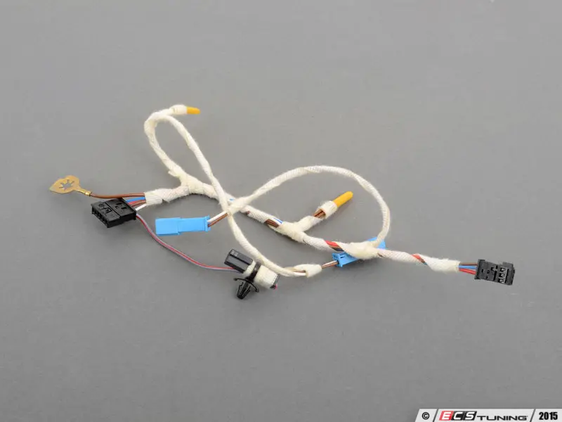

If the cutouts are there, you will still need the internal wiring harness that fits inside the steering wheel. That harness connects the paddles together and connects to the system (inside the wheel). Then you need to code the car to recognize the paddles.

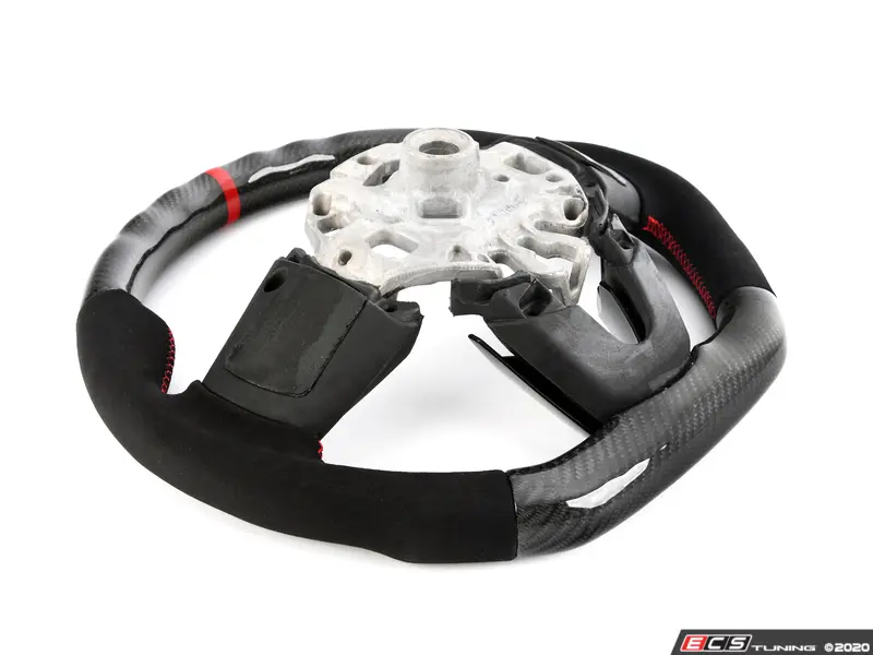

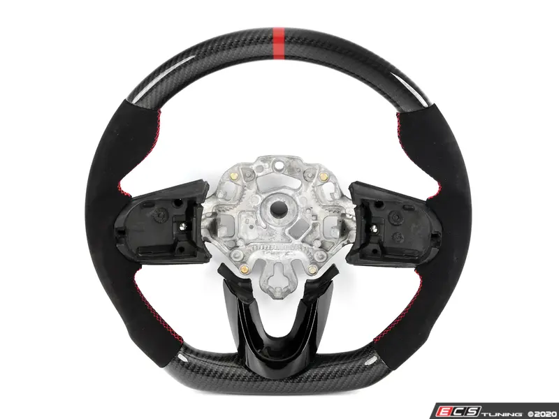

Old Jan 15, 2024 | 01:22 PM
Posts: 36,758
Likes: 2,548
+1 Yep the cutout are on our new wheels, you will need that extra wire set, and those paddles : https://www.ecstuning.com/b-genuine-...t/61319291653/
Extra wires: https://www.ecstuning.com/b-genuine-...t/32306864896/ See they have those blue connectors to connect to the paddle harness.
You just remove those molded pieces on our ECS aftermarket wheel as they are for with/without paddle shifters. Also you have a pretty nice/thicker wheel.
https://www.ecstuning.com/b-ecs-part...0a/c-steering/
