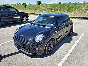

Well, guys/gals, I FINALLY got these wheels/tires mounted and installed. After going through a few issues with what I needed for these to work correctly (TPMS related), theyre finally on. I really like the look and stance. Opinions, good or bad are welcome.
I AM having an issue though; and sadly it is still TPMS related. So the tire shop I had these installed at had an issue with the TPMS sensors I purchased from ECS; these were recommended to work with my car. So I ordered them. Problem was, they wouldnt fit the wheel properly: the metal valve stem was too long and hitting the spoke, not allowing the tire to be filled.
So what did I do? I purchased two more TPMS sets; one from O'Reilys and one from the tire shop. The tire shops was the one that ended up fitting, as they had these super short rubber valve stems. Fast forward to today when having them installed. All was fine and dandy until I left the shop. The sensors will NOT connect to the car and read the tire pressure.
These are supposed to be universal sensors. I HAVE to have these short rubber valve stems in order for these wheels to take TPMS sensors and the tires to be aired up, but for some reason these sensors wont connect with the car/or vise versa.
Does ANYONE have suggestions? And what is more aggravating, is I paid way more for these sensors and valve stems at the shop then I did anywhere else. So I was really praying they'd work. Of course, they didnt. My luck.

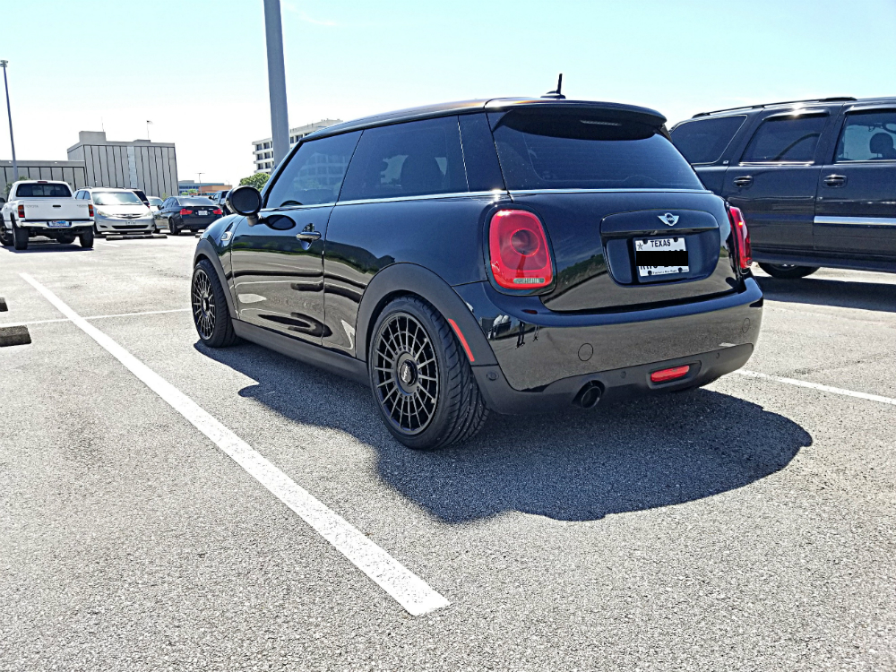

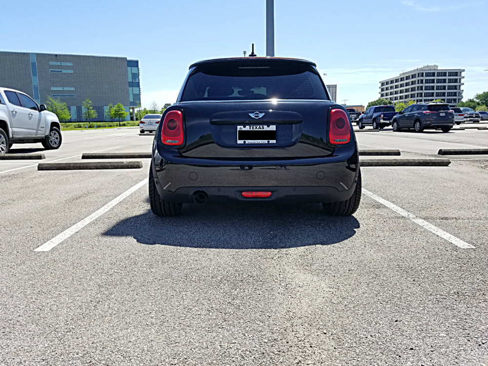

My second issue is, the rear wheels are super flush with the fender (I love it), but the front wheels stick out about 1/2 or less, but its noticeable. I'd really like the front to be flush with the fender like the rears are. Any advice? Can I have the fronts milled a small amount?
Anyway, here are some pics of the car. Will get better ones once the weather clears up and I can wash it. I recently deleted the rear Cooper badge and also did a KillAllWipers rear wiper delete kit for the F56 (this is a must, IMO!). I really like the way it turned out.
Attached Thumbnails Wheels are FINALLY installed but, NOT without ISSUES! (HELP)-1.jpg   Wheels are FINALLY installed but, NOT without ISSUES! (HELP)-2.jpg

2 things:
- Were your stock TPMS sensors close to the car? The computer could be reading them if they were close to the car still.
- Maybe its just the picture but are your rear wheels really pointed in? The camber looks really off. Like I said, it could just be the picture

The ride home I had the stock wheels/tires jammed in the back of the car, so that could have been the issue then. However, I went straight home, dropped the wheels/tires off, and went back out driving for about an hour just to try and reset the sensors.
Heres an odd thing... I just went to the store and the car automatically started to try to reset the sensors. After about 30 seconds it got to 18%, then I got the failed error. Not sure what was different. So I tried the same scenario again and nothing. Hmmm. Decided to give it one more try and it slowly climbed to 49%, then got stuck there and gave me the failed error. I tried it once more since I had it working twice. It never got past 0%.
My car has the slight rear negative camber that all Mini's have. I recently had it aligned after lowering it, and all camber was perfectly within factory spec. I think it may just be more pronounced because the car is lowered, the larger wheel track and the lower position angle I took the pic from?

What about swapping out the front wheel arches / flares to the JCW arches / flares? Don't the JCW flares have a small additional lip on the upper edges? That little bit may help in terms of appearances of the front being flush.

Thought about this last night, as I was looking for options. Might be the way to go, but going to keep looking before I grab them.

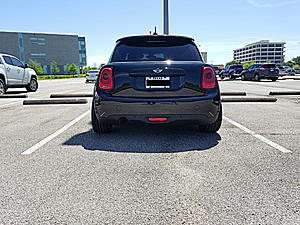

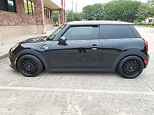

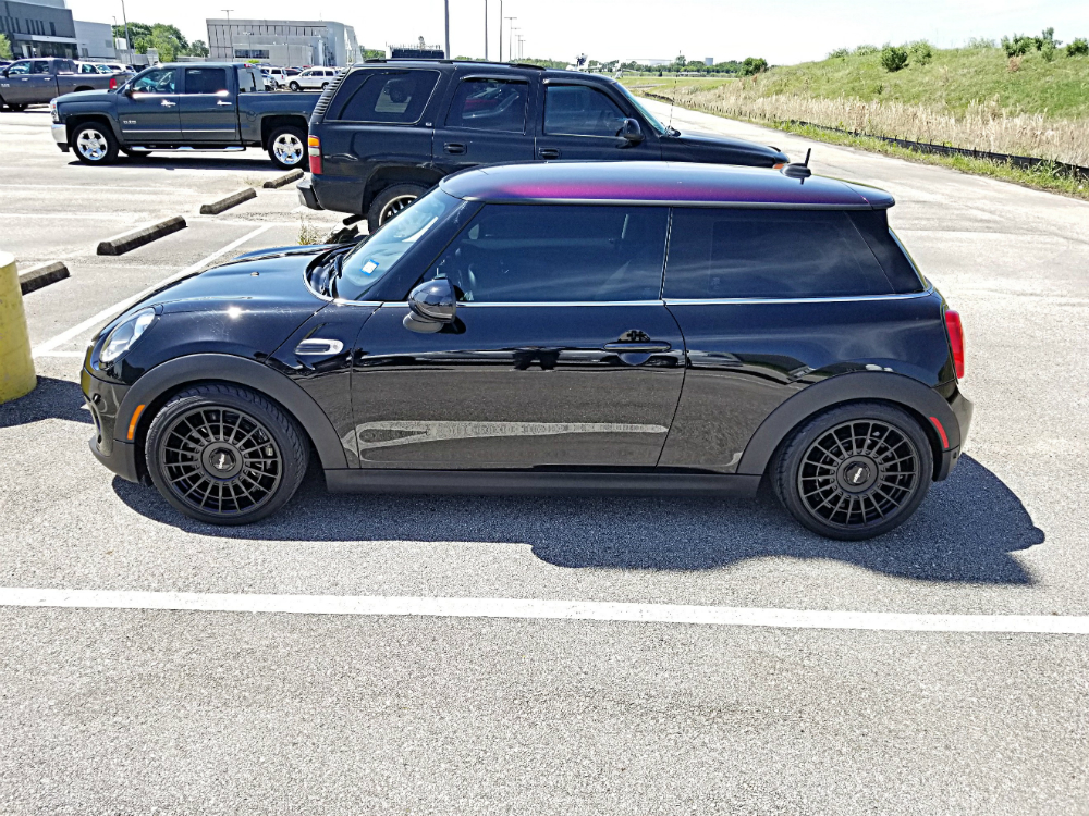

A few more pics since the sun is out.
Attached Thumbnails Wheels are FINALLY installed but, NOT without ISSUES! (HELP)-3.jpg   Wheels are FINALLY installed but, NOT without ISSUES! (HELP)-4.jpg   Wheels are FINALLY installed but, NOT without ISSUES! (HELP)-5.jpg   Wheels are FINALLY installed but, NOT without ISSUES! (HELP)-6.jpg   Wheels are FINALLY installed but, NOT without ISSUES! (HELP)-7.jpg

Great, would love to see more pics when you can! Maybe a lower angle so the wheels don't look like positive camber.
Find a shop that specializes in wheel machining to ask about milling the backside. In LA, I used JR's Machine- maybe they could at least answer the question, although they probably will say they have to see it. Guessing that it's usually not recommended, unless the wheel was designed to be custom fit... but maybe there is a general rule of thumb for acceptable thickness.
But I'd say as long as it doesn't rub, you're good. JCW fenders aren't any wider, they just have an extra lip on the outside. Might help with appearance. Probably meant to control water spray.

Ah you just posted more... nice. Wheels look great. Yeah I see that extra poke in the front... Front camber plates would help as well. I think the only one available so far for OEM mounts is the K-mac.

I will get more pics after I wash it, and hopefully the weather is still as nice as it is today. Definitely no positive camber; just offset and width is aggressive. It actually looks better in person, but I still want to see if I can do something about the fronts. There is a slight rub when going over large bumps/bumps with turns, but nothing terrible that I can tell.
I've been looking at the JCW fenders this morning and dont think I will go that route. As you mentioned, I dont think theyre any wider.

I tried getting better pics of the top. It really just needs to be seen in person. It looks REALLY good.
Your ideal situation would have been to get wheels with 5mm less offset, and add 5 mm spacers to the rear.
The rear camber being more negative is making the rear look flush. Unfortunately you can't adjust front camber.

Exactly. Unfortunately, they dont make the particular wheel I have in a 17x7.5, or that's what I would have gone with.

Maybe just add more camber up front.
