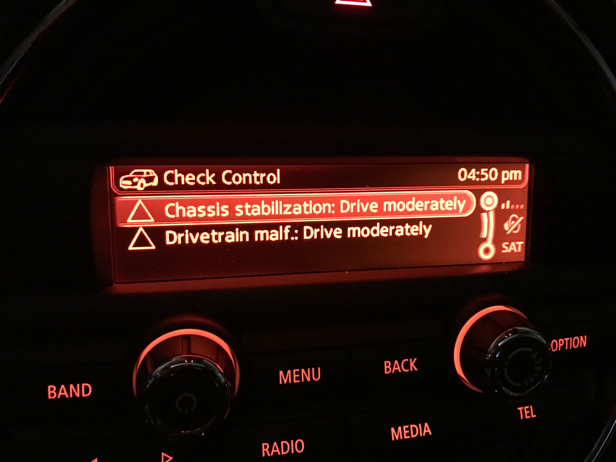

Well, it's more than just one random glitch and I'm pretty sure it's not the Dinan module.
On my way home from work today, I had some rough shifts and the return of that drivetrain error. Then, I got a couple rougher shifts and a chassis stabilization error:
At that point, I think I finally got to experience limp mode. To make things more fun, the car died at a stop light and refused to start for a couple of minutes. Thankfully, I did get it restarted and managed to get home.
I now have a loaner waiting for me at the dealer, a service appt for tomorrow and BMW roadside is on their way to bring me and the car in. Good times!
And, yes, while I'm sure this isn't the dinan, I did remove it to be safe.

Forgot to share the worst screens ever:
Both of these errors persist when I stop & start the car.
And the saddest thing I've seen in some time:
