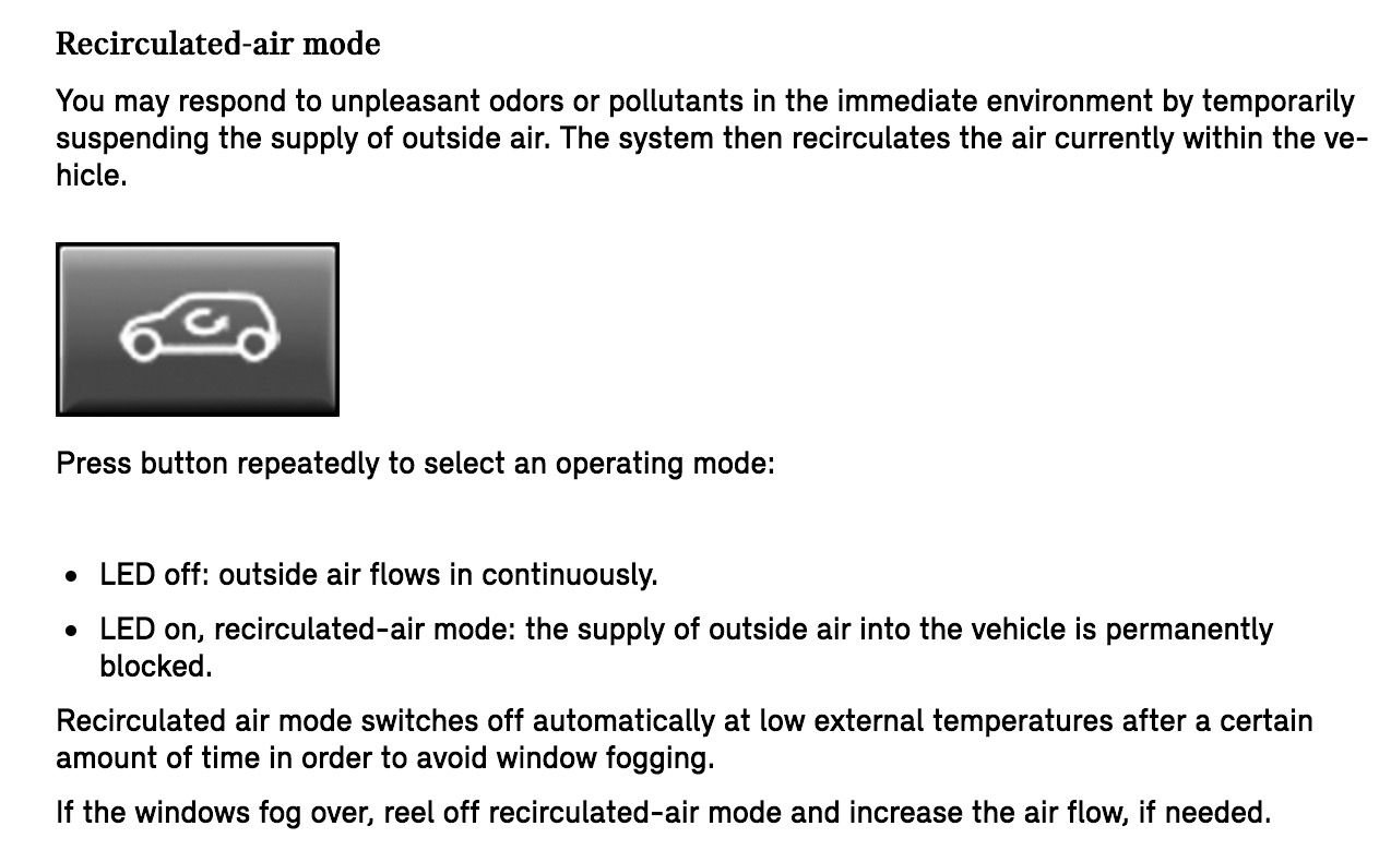

So what is the deal with the air recycling button?
When I first got the car it stayed on even between shutdowns. Now it only stays on for 30 second before going back to normal. I coded it to remember but that had no effect.
I was wondering if the filter was dirty.... But the car is only a year old.
I also had a 2014 F56 that displayed similar symptoms.
Any thoughts¿

It's the cold weather. It's -20'C [-4'F] here now and the recirculate only lasts for 17 seconds.
I have a trick for you! It's not easy to do, but it works on my car, and I hope it works on yours. Do this before you start out. You need a watch or if you are listening to a podcast or music, you can use the time there.
First, when the clock gets to 00 or something, turn the recirculate on and note when the green light goes off. Like I said, it's 17 or 18 seconds when it's cold enough.
Now, turn the recirculate on and then press the button again just as the green light goes off. This has to happen within one or two tenths of a second of the light going off, half a second is too long. You basically have to be pushing the button as the light shuts off.
If you didn't get it, you will hear the change in air flow as it goes from recirculate to fresh air and back to recirculate. If you got it, or almost have it, you will not hear the air flow change, and after 17 seconds the light will still be green.

The trick is not that amazing because it's really hard to do, and it is not permanent, it doesn't stay on when you shut the car off.
If you were to wire in a PIC, it would solve your problems, but that is merely speculation on my part, I haven't looked into it at all.
Stock behaviour is unfortunately how your car is operating.
