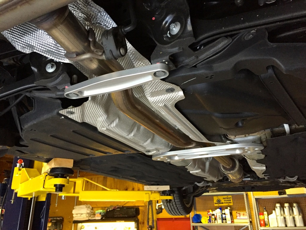

I have both, but I couldn't truthfully say which made the most difference. Like you, I think the bar is more looks than anything else, but I like it. The big pair was my first mod on the F56.
