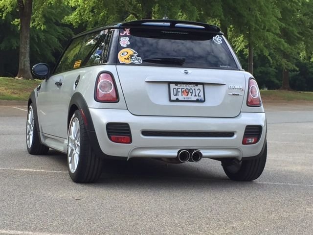

I found some at Oreilly for 25 bux a pop. Clamp on's

Those O'reilly ones look perfect and what I am after. Are they stainless? Can anyone confirm the size of pipe inlet and outlet?
Is it these, both have 2.25" inlet?
3" outlet
http://www.oreillyauto.com/site/c/de...0905&ppt=C0112
3.5" outlet
Perhaps this?
http://www.autozone.com/exhaust/exha...on/912944_0_0/
All of these are like $50 a piece. If we can confirm the stock outlet pipe then I might gamble and order.

None of those are what I bought. They are stainless yes. You can take off one of your stock tips and measure.
