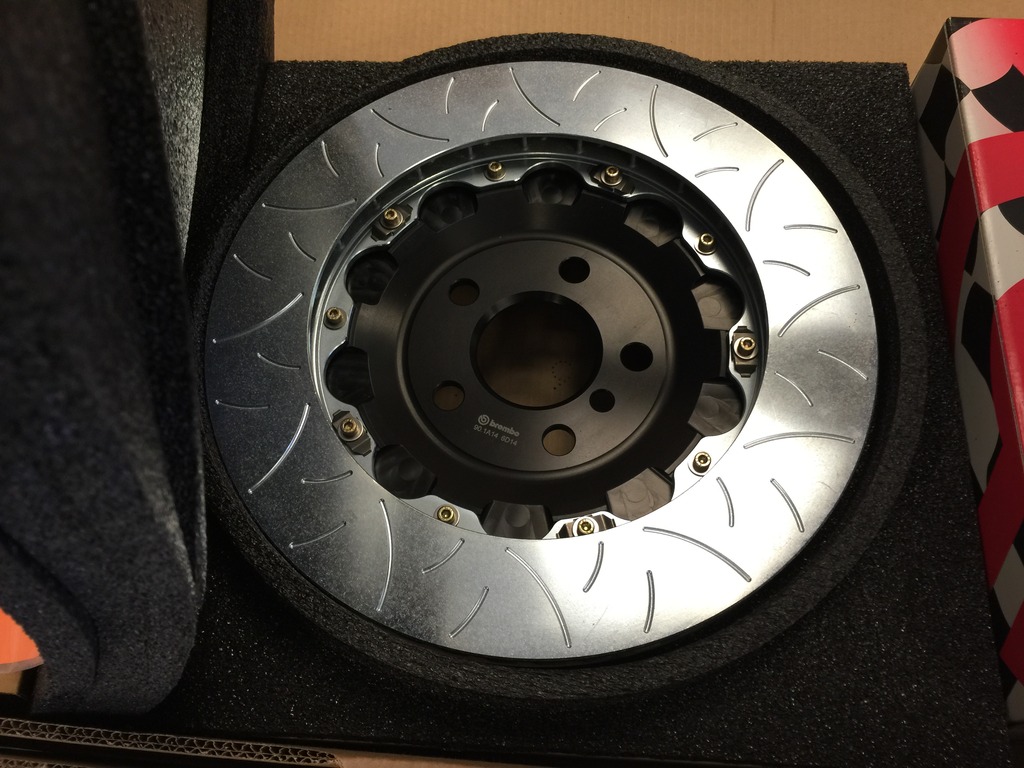

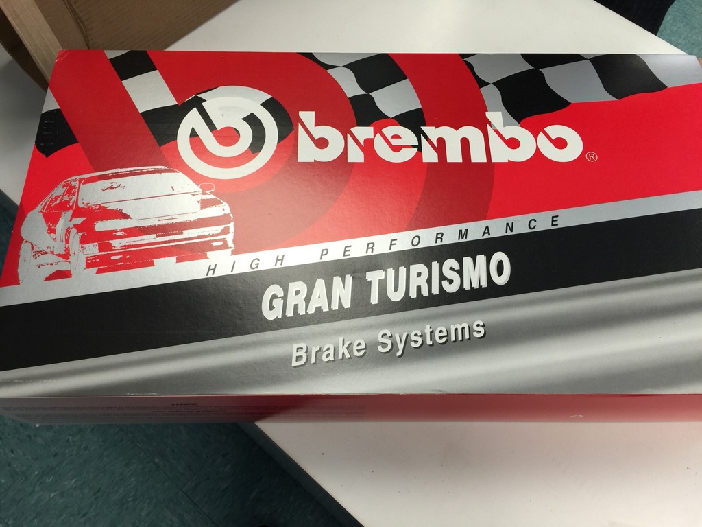

Will post more pics when after they get installed. As always, shout out to my peeps at IND-Distribution for the making me break my promise to myself to stop modding.

Here's another one.....

this may be a stupid question..but these aren't the JCW BBK are they...or are they something else?

They are not. These are actual Brembo brakes made by Race Technologies. I think the JCW Kit may be made by RT as well but not sure, but they are different kits.

these are NOT the jcw kit. Not with those beautiful floating rotors and monoblock calipers!

the rotors gave it away...i'm no brake expert but the little i knew was that the JCW kit isn't as fully brembo as a true kit...and this seemed like it but just wanted to confirm. thanks. does look perty...and probably cost you an arm and a leg.....and a few extra toes.

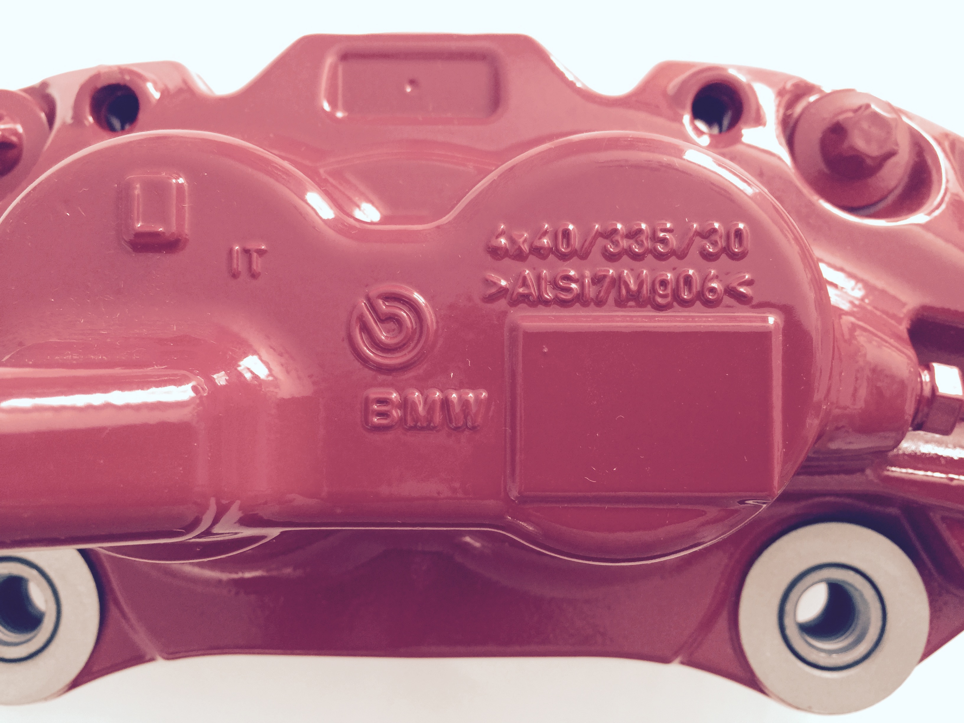

Jcw Seems quite Brembo to me

Out of curiosity... is it possible, and would it make sense (cheaper), to order the same JCW kit through other routes? Like figure out what Brembo part # the calipers are (pic above?), get some 3rd party rotors, and the only OEM MINI parts are any mounting brackets.
just mentioning what has been spread around, and that is that the JCW kit, while stamped as brembo, isn't your typical brembo kit. i personally do not know the difference and only wish someone would jump in and explain the difference.

"MINI offers Brembo Brakes on the JCW models, but the JCW brakes has smaller 335mm diameter 'solid' 1-piece rotors (not drilled or slotted) compared to this Grand Turismo Kit with 345mm x 28mm 'full floating" 2-piece rotors with Aluminum hats for less unsprung weight (for improved handling). The discs supplied in the kit feature an exclusive venting system that improves cooling capacity and increases resistance to cracking caused by thermal shock by over 40%. The holes or slots in the braking surface help dissipate heat and eliminate brake dust and gases."

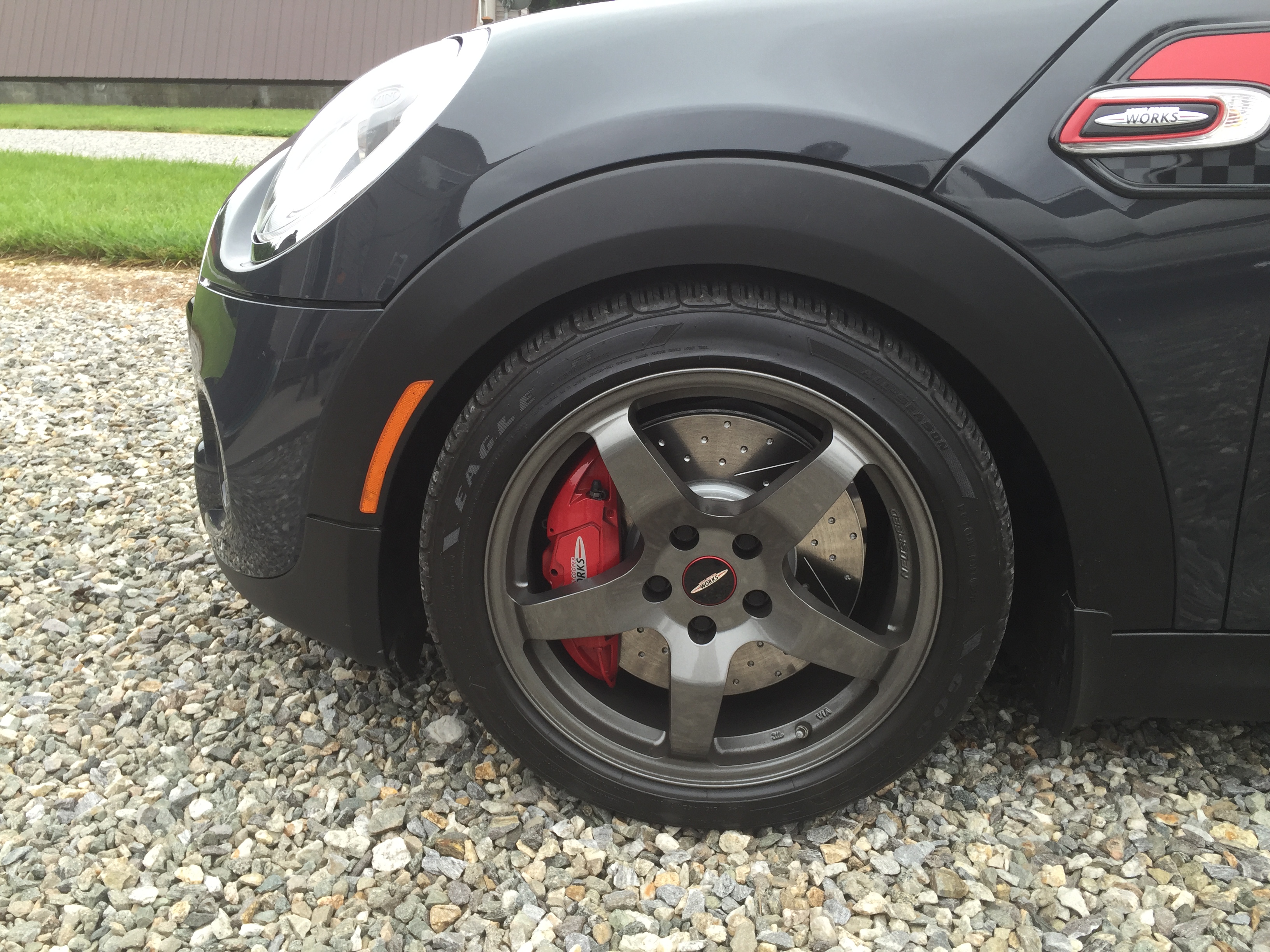

Okay. Less than a half inch difference in diameter, but I really do like the two piece rotors. I wonder how the replacement prices will compare. I haven't looked into that yet. I guess you could say my front rotors are solid because they are dimpled and slotted vs drilled. But, you could say the same thing about the Brembo kit too. And you're correct... The JCW kit is not your typical Brembo kit simply because it is made by Brembo to meet Mini specs.
