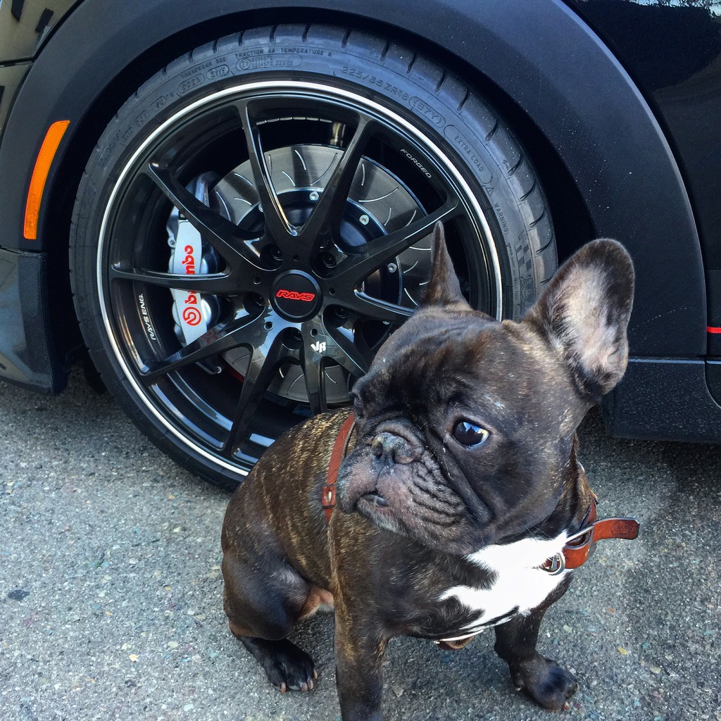

Yeah....love these wheels! As does my dog Oso

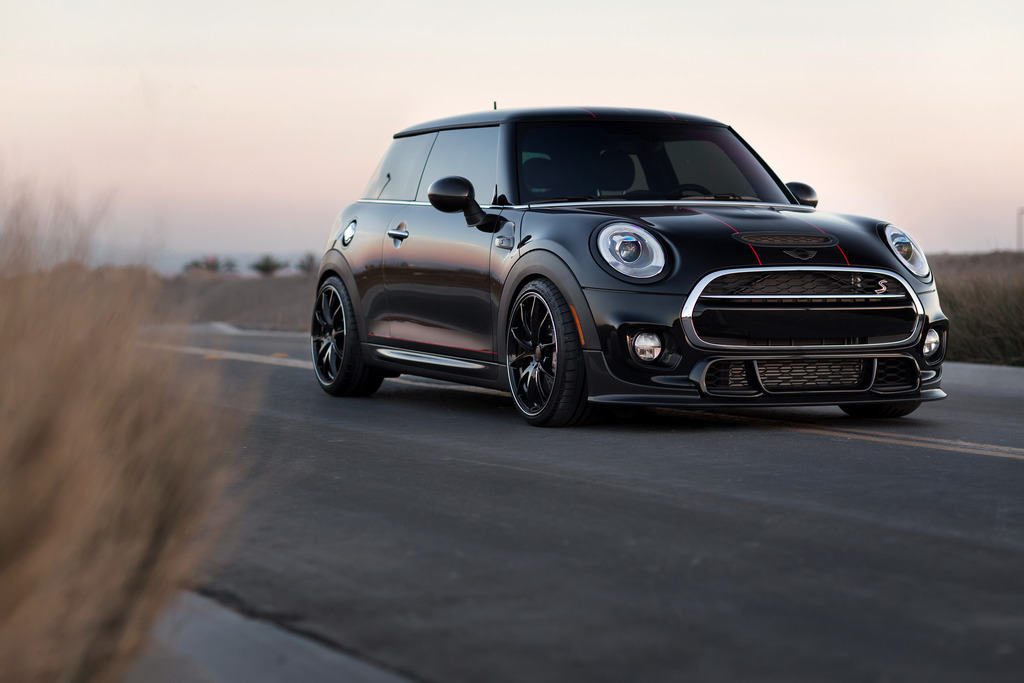

The full view
Attached Thumbnails Some Brembo goodies getting installed today....-image-1892695367.jpg
