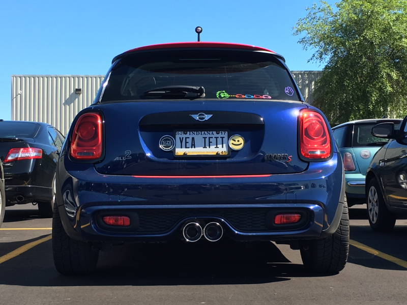

All done
Attached Thumbnails Mini F56 S: anyone deleted muffler or resonator yet?-image-3583278545.jpg   Mini F56 S: anyone deleted muffler or resonator yet?-image-3593377866.jpg   Mini F56 S: anyone deleted muffler or resonator yet?-image-1469939578.jpg
Old Jun 21, 2016 | 09:45 AM
honderpilot's Avatar
honderpilot
Joined: Jun 2014
Posts: 654
Originally Posted by cub4bearindiana
All done
Sweet tailpipes!!! How do you like it/how does it sound? Love to hear a soundclip they worked with the 2.5? Congrats man!
