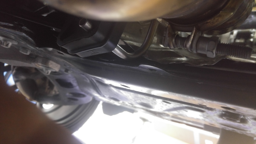

Hey guys,
This last weekend I got around to installing the catless downpipe from MarioKart here on the forums. He was super helpful and responsive and got the dp out to me quickly.
Install was a learning process of what needed to come out and how to take things out. It took me about 4 hours to install. If anyone is looking to do this job and has questions please feel free to ask I'd be more than happy to walk you through all the steps. It is a very easy process.
I got everything installed and tightened down. I was even able to use the oem heat shields without a fight. Everything reinstalled smoothly. On my first drive I had rattles and clunks. The rattles I have come from the heat shields on the downpipe. I removed the upper heat shield and they almost completely disappeared. I then removed the lower heat shield and the rattles went away completely. The clunk was not part of the heatshield. The clunk came from the driver side hanger. It looks like it's just a little too low and hangs about ~1/2" above the subframe. With the engine movement it contacts and that's where my clunk comes from.
I'm looking for ideas on how to solve this issue. The only option I can think of is to take the dp to a local machine shop/tig welder and have it cut and rewelded so I have additional clearance. When I look at the hanger on the car I should be able to free up another 1" without issue.
Are there any other options that you guys can see? Any adjustments I can
make to make more clearance?

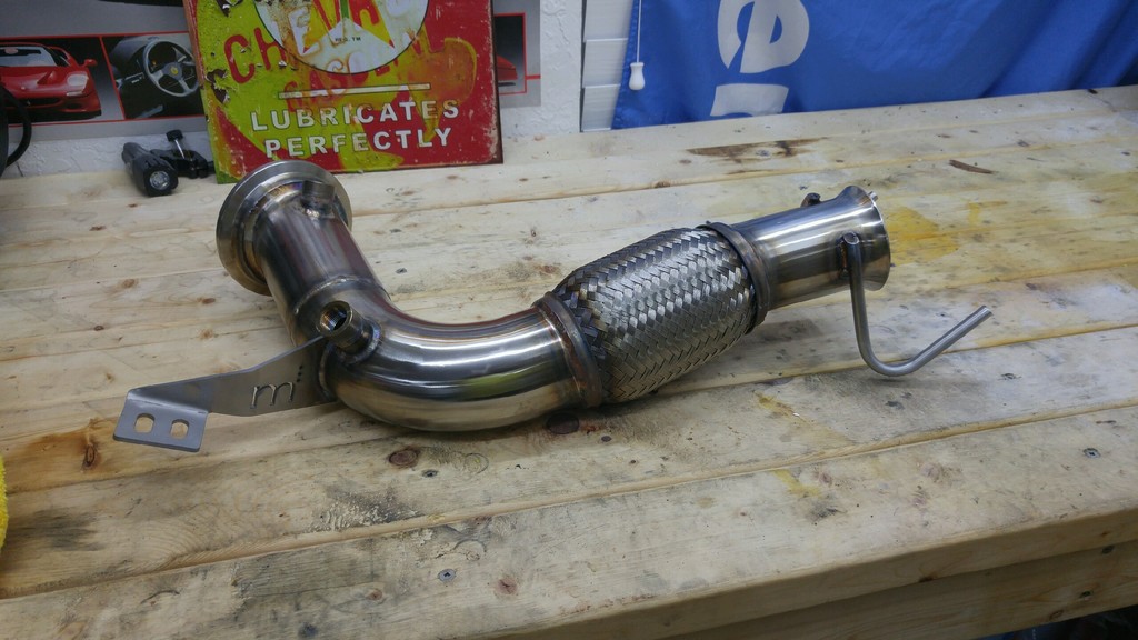

And for your viewing pleasure here is the dp fresh out of the box. It is a thing of beauty and after I put a couple heat cycles on it, it really got some nice coloring started.

I have a 2016 F55. This DP has, what I've used on previous vehicles, to defeat cel's built in. I can get a picture tonight but the bungs are spaced further away from the dp and there is a perforated piece of metal in the bung to limit exhaust gasses getting to the sensor. From my experience this setup will give the sensors the temperatures they're looking for and not throw a cel.
I tried to bend it lightly but I didn't put any muscle behind it. Also I'd have to change where the bend is on the hanger instead of making the bend tighter or looser. The hanger contacts the subframe in the middle of its bend.

Damn that easy to swap back out for the stock one lol.
I would try heat, a wrench and a vise and bend it but I'm cheap and want to do it myself.
Might as well take it to a metal shop and put a marker for the guy where you want it tacked at.

Holy ****.. Finally someone else.. I had the exact same problem.. Had the helix guys install it.. They bent the hell out of the hangers to make it fit w/out hitting the subframe.

Did bending the hanger fix the fitment? What's your year and model? Did you let Mariokart know about the fitment issue? I spoke with Mariokart last night and he told me that he had not heard anyone else run into fitment issues and I asked if he had it on an F55 before. He had not, and asked if I would rent him my downpipe to double check fitment against his jig. He seemed genuinely concerned and wanted to fix the problem.

yes, bending it fixed it...but i'm telling you i bent the hell out of it. well, the helix guys did. feel free to give them a call and ask them.
as for me telling him, i sure did...and he said the same thing...installed on 10 cars and noone had an issue. the downpipe may be good one, but the hanger design straight up sucked.

MarcoPolo: Well I am very happy that it is only a hanger that needs to be adjusted and not a flange or the pipe. Still a little worrisome that we were told the same thing about no other fitment issues.

I did get the downpipe on this weekend. For some reason I thought the downpipe hanger was a solid bar. DUR...(way to look at the open end of it walkingdrunekn) So I got the downpipe back on the car and used a box end wrench to bend the hanger. It was very easy and non-complicated. I used a small offset wrench that I slid over the hanger. That gave me the leverage to slowly bend to exactly where I needed it. I also got all the OEM heatshields back on and I have zero rattles or knocks to speak of. Overall I love the result of the downpipe and love that it is a bolt on application. I'm dissapointed that the fitment was off, especially with MarcoPolo reporting the same.
