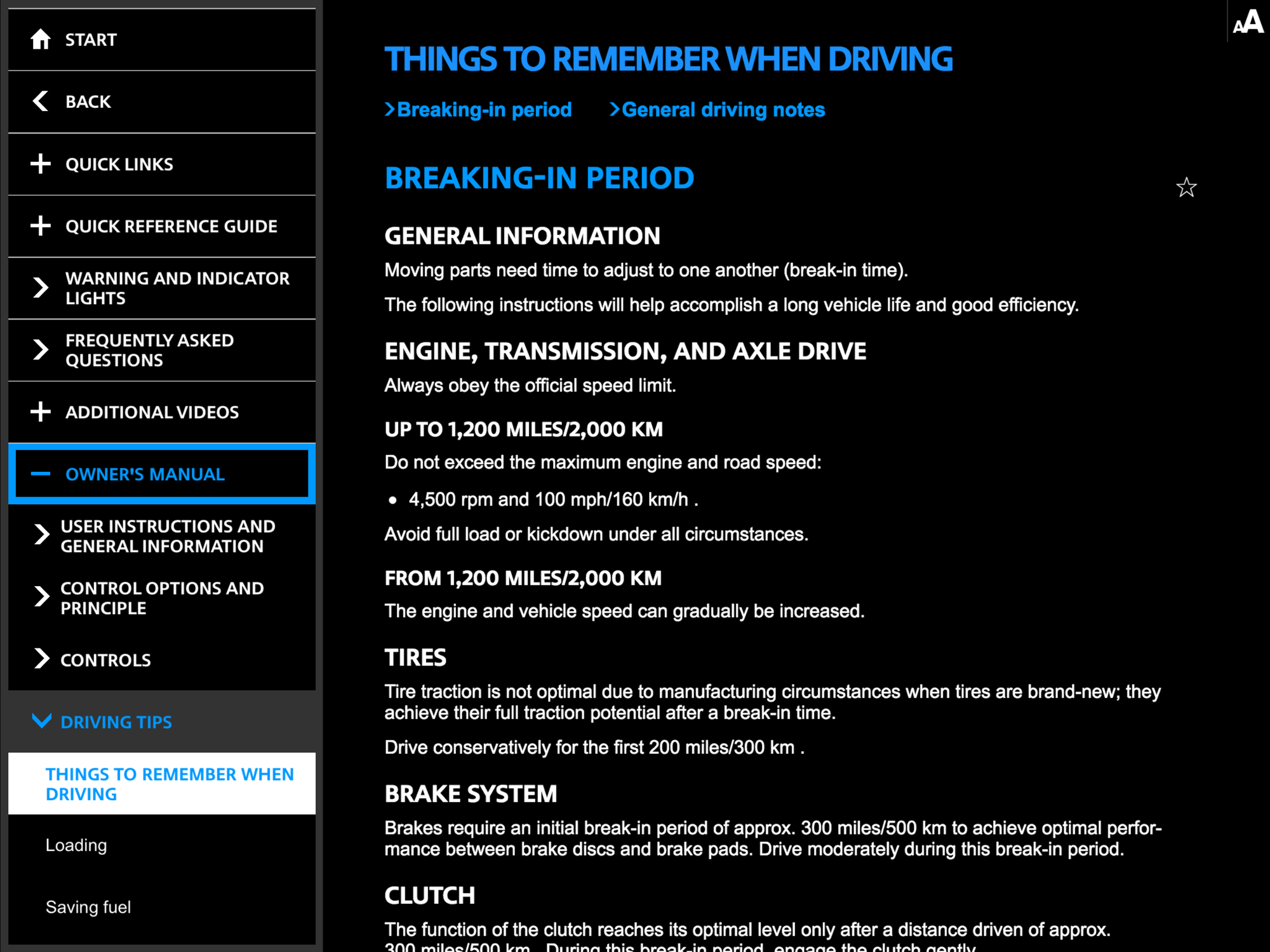

Originally Posted by jrodri7
I thought break-in period was 1,200 miles? I replaced my oil at 1200 last week when it went in for the bearing TSB
Mine says 1000-1200 mi
I think.

Ok great I just looked in my manual and say that thanks.
I emailed my salesman because I could have sworn he said 1000. Im sticking with the book for sure though.
