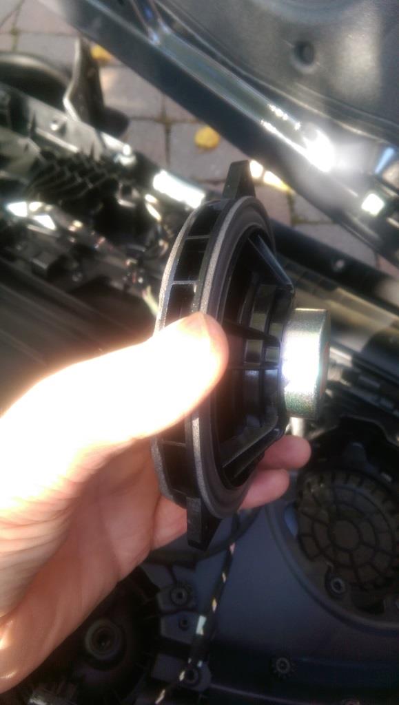

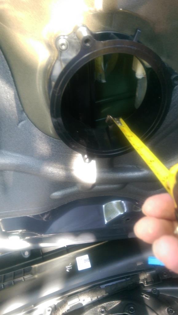

Sorry misread......yes 4" is correct. 3 bolt pattern though. Most 100mm speakers are 4 bolt so you will need to make a template.

Old Sep 2, 2015 | 02:50 PM
GregoryK's Avatar
GregoryK
Joined: Dec 2007
Posts: 1,884
Likes: 19
From: Far North
Check my photos. You will never bottom out the door speakers.
I use KRS 100's (Focal). When you buy a small run made to fit in a BMW/MINI speaker most of your money goes to that and not the quality of the speaker KMS 100's are another world from the IFBMW-S and cost around the same. They are 4 bolt pattern though so you will need an adapter ring.
