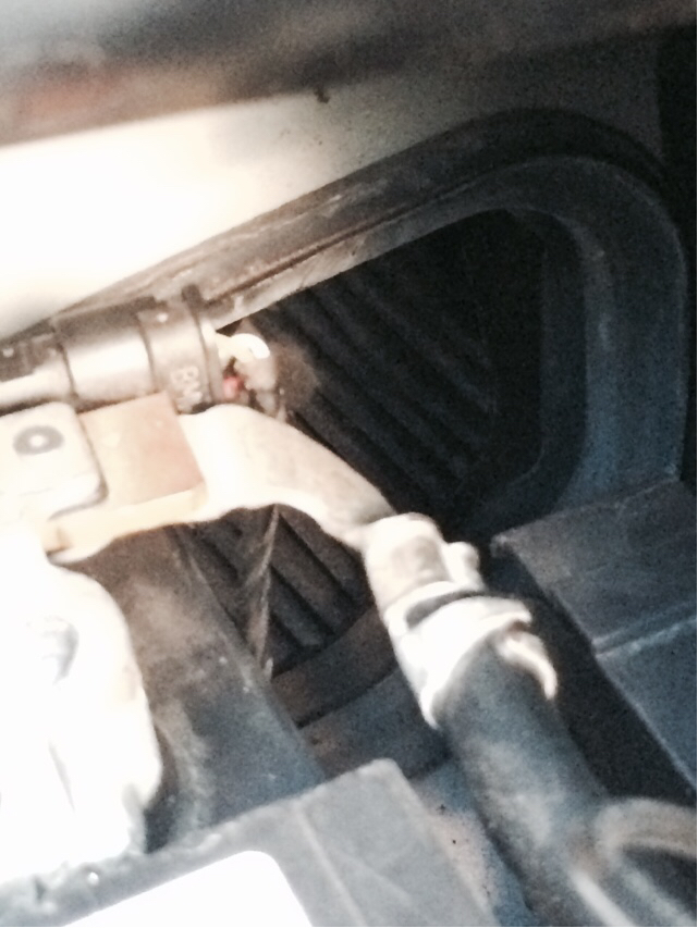

In my 2013 S coupe, there is a vent outside just below the windshield. The opening for outside air to come into the cabin is located on the passenger side behind the battery. Looking at it right now. It's a pretty big opening. The cabin filter is clearly visible right at the opening.

Here is the opening , you can see the cabin filter
Attached Thumbnails Another Vent filter other than the cabin filter?-photo37.jpg

I had a funky smell from my air conditioner. I found a mouse nest in the cabin air filter, it was a big pile of moss. I cleaned it out and wiped it down with disinfectant and got a new cabin air filter. Then I made a grill out of metal gutter screen for the cabin air intake behind the battery, no problems ever since.
