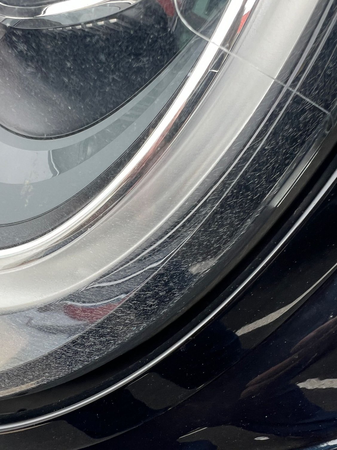

No, they didn't cover it under warranty. Which is annoying because, in my opinion, the cracks are on the inside, not the outside. So I never tried to polish or repair them. I just lived with it until I got a new MINI earlier this year. Old was a 2017 with halogens. My 23 has the LEDs so hopefully they are higher quality.

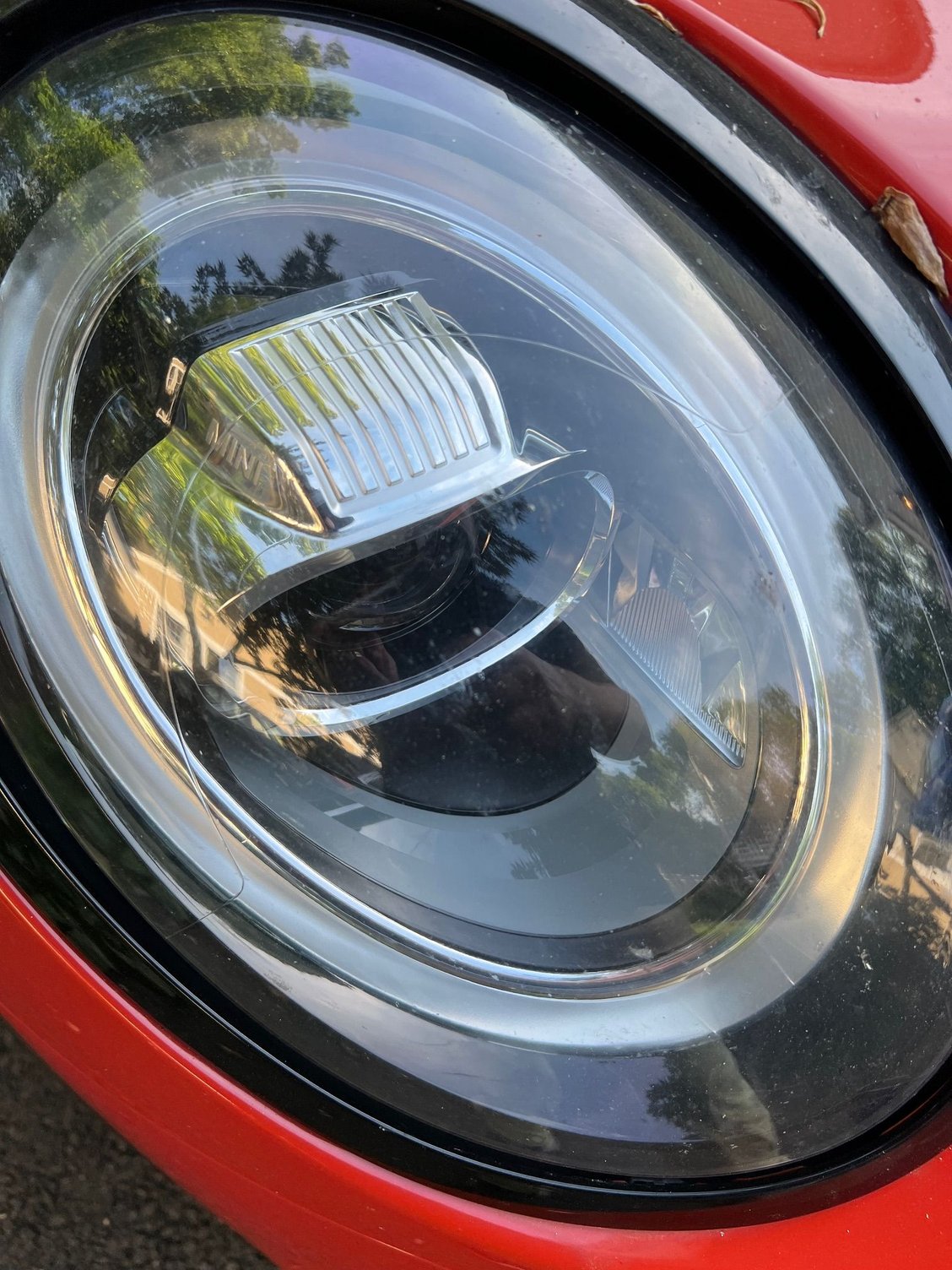

Had this issue on my 2020 Clubman (still under warranty). BMW did not cover which doesn't seem right as the car only had about 12k miles on it. I also have a 2019 JCW and those look great no issues. Definitely on the inside and there's almost no way this is caused by the owner. Frustrating response for a car under warranty. See pics - black car is my 2020 Clubman, Orange is my 2019 JCW. BMW had no rationale other than not covered, which is not great. I have heard of some folks getting it covered, others not. If anyone has actually had these covered under warranty, would love to have that insight.
