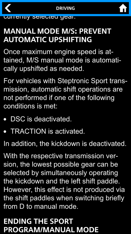

Great write up. According to the JCW owners manual there is a way to prevent the car from up shifting automatically. See below
This is awesome! Thanks for the info, knecht. I have not made it all the way thru my owner's manual. I thought I had heard that disabling DSC affects the transmission. Good to know.
