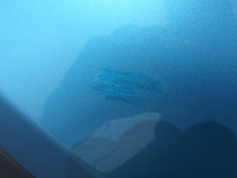

I had a small chip on my front right fender that I decided to tackle with touch up paint today. Big mistake. I was under the impression that the paint took a while to dry because the package said to wait 30 minutes before applying the clear coat, but as I was trying to feather it the paint started drying and globbing up and now it looks a million times worse than before I tried to touch it up. I'm in panic mode; I found this article on how to remove touch up paint and I'm going out to get these supplies right now: http://m.wikihow.com/Remove-Touch-Up...n-the-Car-Door
Any tips or warnings would be greatly appreciated.

i'm more scared of what you're going to do with that thing on a drill than the paint mistake.
maybe get some polishing compound and rub it off by hand with a microfiber?

I was able to use the little square of sandpaper (300 grit) in the kit and it looked 100 times better, but obviously i took off a lot of the clear coat. I painted over where I sanded with clear coat about 40 minutes ago. It just started raining - whenever it stops I'm going to buff that out. I'm almost positive it's going to look as good as new when I'm done. I'll post pictures. I'm not joking though - I thought my heart was going to stop when I realized what I had done at first.

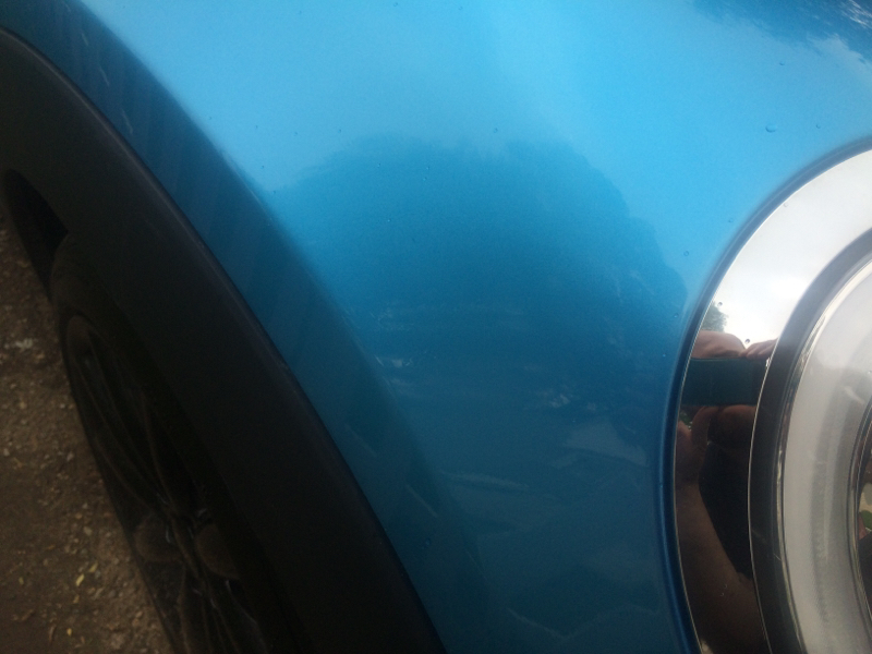

Can't even tell now. Whew.
